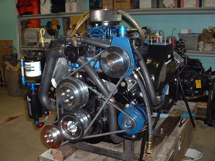

Your pump is different than mine. I'm running the automotive style that mount up high on my motors, with their own internal reservour. I have an external reservour that feeds the top of them.
Last winter, I added hydraulic quick disconnects to make pulling motors less messy. I had a problem with one of my pumps not pumping, and it turned out that the size of the fittings from the external reservour to the top caps of the pumps were too small, not supplying enough fluid to operate the pump. My symptom (other than stiff steering with just that motor running) was the external reservour would back up to the point of overflowing.
Is it possible that you have a restriction from your reservour to the pump?
I have dug into one of my old pumps to see how she ticks. There's a rotor inside with a series of steel vanes that act as an impellor, some valving, not much else.
Does yours come apart? Might be time to dissect it.

Some pics of my setup...
Attached Thumbnails HELP? I cant get the Power Steerring Bled-engine_front_sm.jpg   HELP? I cant get the Power Steerring Bled-engines.jpg   HELP? I cant get the Power Steerring Bled-ps_disconnect1-sm2.jpg
