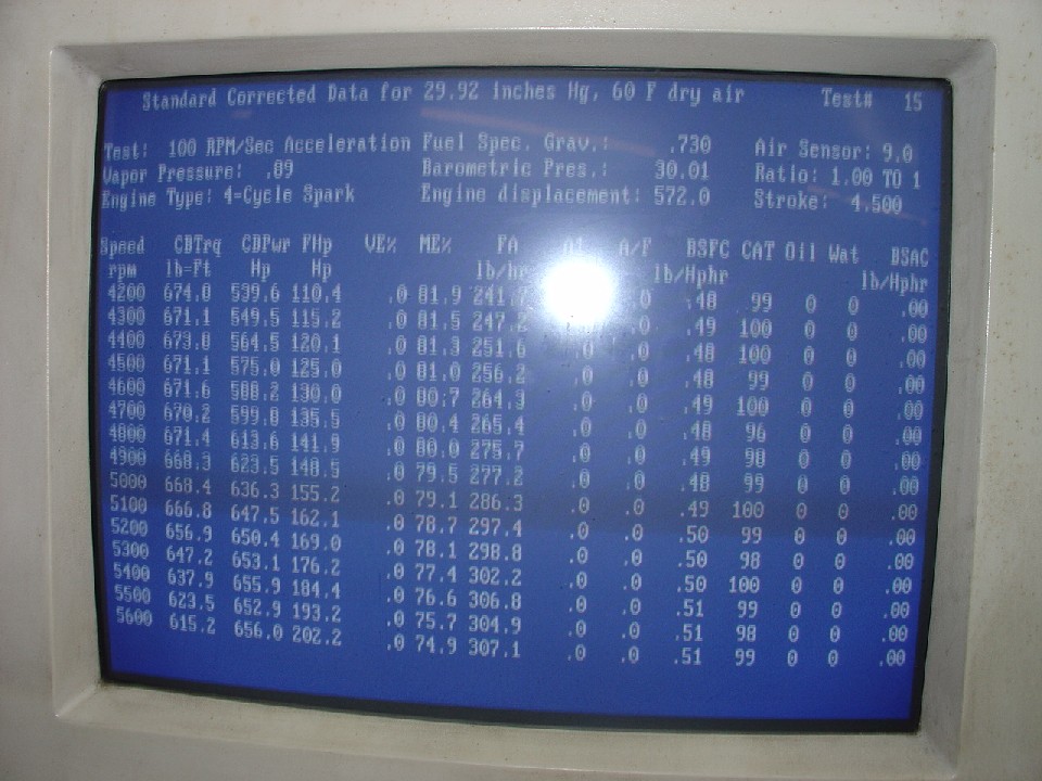

here is the print out on the second engines pull.
Attached Thumbnails video of my 577's dyno pull, whats it worth?-post-pic.jpg

Well..I see what my guy does and it seems to be a wayyyyy lot more than most of the runs I see on this sight...that job is worth nothing!!!!..if you want to be nice give him whatever...but I would have your motors dynoed by a pro with all the readings and redialing done right there....motors run much better when done right!
