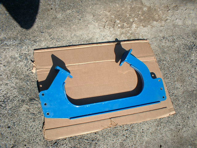

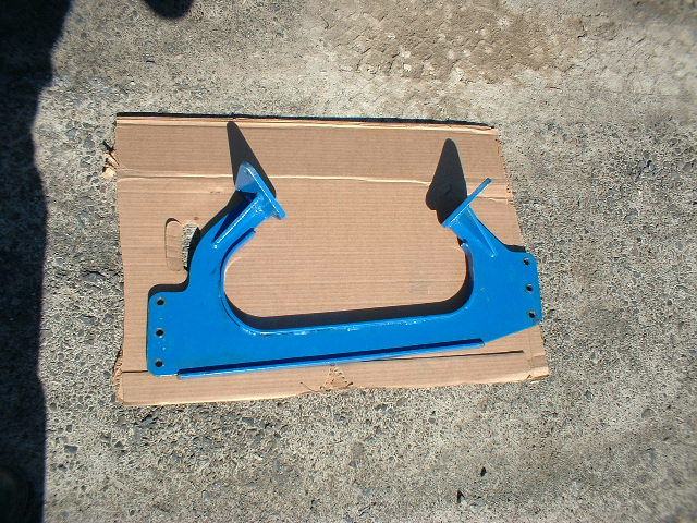

ive got a nice set of mercury racing solid offshore motor mounts in excellant condition , il sell the pair for $150 plus shipping let me know if interested
thanks kevin
Attached Thumbnails Solid Motor mounts-merc-mtr-mnt.jpg   Solid Motor mounts-merc-mtr-mnt2.jpg   Solid Motor mounts-merc-mtr-mnt3.jpg

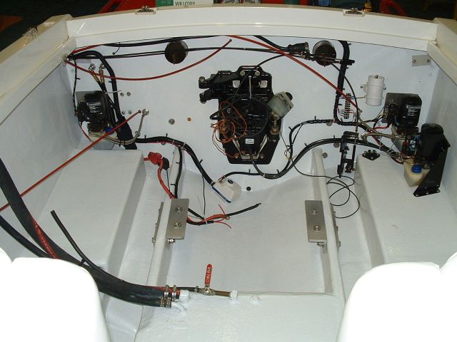

I was looking at those. Do they use the locking tabs from the stock mounts? How do the stay locked in position? Here's a pic of what I have to secure them too.
