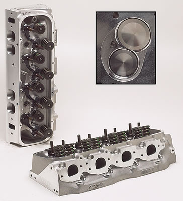

D port head most people are talking about the exhaust port shape. Peanut ports are very small intake ports about the size of a golf ball. Oval port are also talking about the intake ports, they are about the size of a 1 1/4 hose. Finally the square port or rectangular port is large from top to bottom of the intake runner. Its name is its shape.
John S.
The first picture is a standard oval port, the second is a rectangular or square port and the peanut isnt shown but is another 1/3 smaller than the oval port.
Hope this helps.
