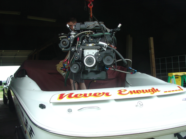

Hi Smitty,
Can you give some more detail as to what was needed to make that adaptation for the alternator. Do you have any pics, etc,.
Bob

I found a alternator in a catalog rated for marine use,it was very close to fitting except it used a v-belt instead of a serpentine. I used a small spacer(about .050 or .100 thick) and the dia of the shaft to get my pulley to line up opn it and not rub the alt body,it bolted to my stock bracket (it had 3 holes and one of them lined up,I attached the only pic I could find),couldn't tell you much more except its definately fatter in diameter (the old one was a hitachi style),it was 5 or 6 years ago,Smitty

Thanks, I will look in to that option.
Bob
