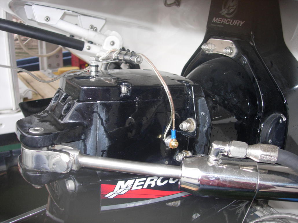

Well to provide a temproary means to test for the drive temperature a modified Livorsi oil temperature sensor seems to work. The Hex head had to be cut down to clear the ID of the drive's oil fill hole recess. This additional mod is not shown in the sensor mod picture attached.
Recorded 270F at 5800 rpm run with the drive shower shown.

Rage,
you need a better drive shower.. 270* is too hot!
