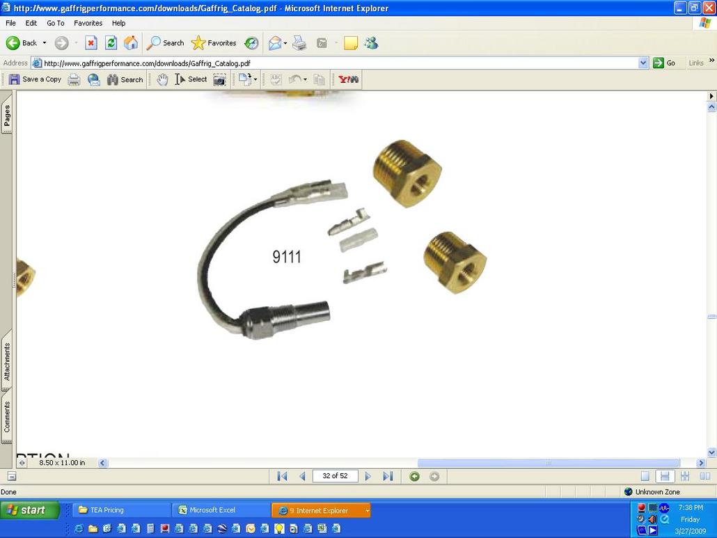

Hey Daredevil, It took me a while to figure it out but I finally found the #9111 sender you mentioned. I see that Rage couldn't find it either. You have to download their catalog in order to find it. I believe it's on page 29 and is the last sender shown. Not many details like temp range but it is clearly not made of brass. $14. though, I'm gonna give it a try. Lets keep this going until someone starts making something to sell or we come up with the combo on our own. Thanks for everyones input on this subject.
I use that Sender for my motor oil temp gauges ...good thing about them is the dual wire setup ...extra wire is for the gnd and you dont have to depend on the sender itself being grounded .....max temp is 300*
