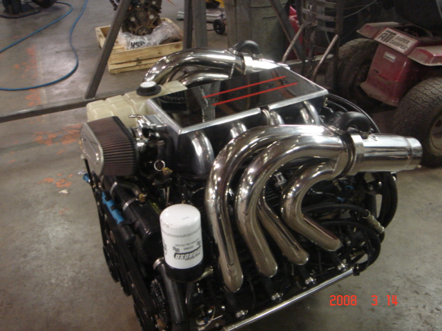

Do it. Its not overkill. It is still turn key setup. I done the 525 kit with the CMI sport tubes/billet throttle body. I put on the headers first. They are good for 5 mph alone! GPS.
Hp and still turn key. If you want to stay with the 496 its the way to go. Power, great sound and is never stalls or stumbles.
Dont get me wrong its not a 598 or 632 cid. But you wont have to work on it at every weekend. Just do your service work and use good oil. I use Mobil-1 15w50 Red top.
