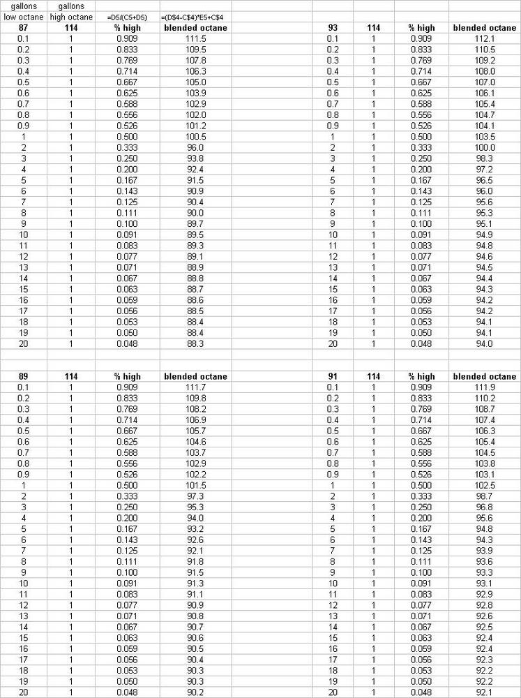

5:1 (20%) Toluene will elevate 89 (R+M)/2, to 93.166 (R+M)/2 octane. The math on determining the ratio is fairly simple. Rather than attach a spreadsheet, I have a conversion sheet that was sent to me for original octane vs. blended octane w/ toluene below. It can be printed and used in the field.
Credit unknown.
Bob

Your eyes must be better than mine!
