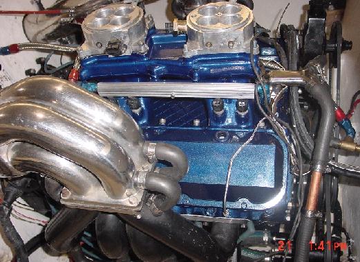

Hey Loy
I changed to a tunnel ram and fuel injection. It should be easier on the drive. I either had to buy a B-max or cut back on the power. I cant keep up with you big dogs

Old 05-21-2002 | 04:02 PM
Joined: Feb 2002
Posts: 1,296
From: LaPorte IN.
Default Tell us more about the injcted motor!
How many cubes and how much HP. Also will solid lifter cams set off a knock detector on injected motors?

Old 05-21-2002 | 04:14 PM
JimV's Avatar
Joined: Nov 2000
Posts: 709
From: Grand Rapids Mi. U.S.
WETTE VETTE
Its a 565ci. 10.5:1 hydraulic roller. It has an aftermarket injection system, laptop programable so it wont have a knock sensor. It made 720hp at 8.5:1 with a smaller cam. While on the dyno with my blower motor a few years ago I swapped to the tunnel ram to see how much power it would make. Im hoping for 750hp with this combination
