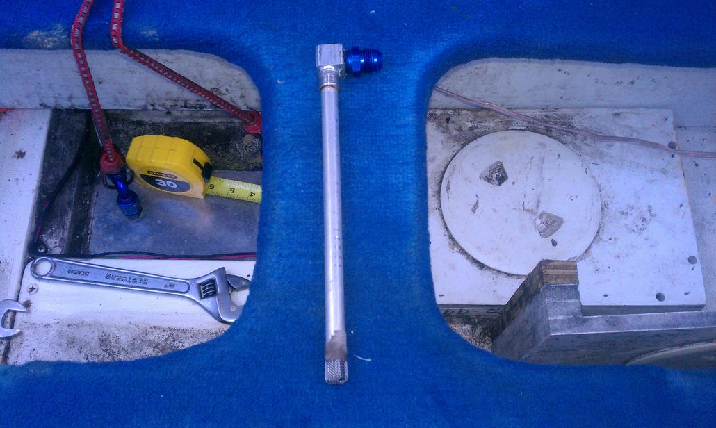

Okay, I brought this boat home last Saturday after purchasing it. I had a chance to go over it some more this am, and can speak with some more accuracy. The boat does have the procharger regulater on it. It also has what appears to be a custom pickup from the tank (bigger) and it get returned to the tank as well. It's all big lines not sure on exact size, I am going to try to figure that out. They are earls fittings. I am going to attach some pics of this as well. The computer is definitely the mefi3. Also found a small procharger module that taps into a temp sensor and the factory harness as well. It called a ect signal conditioner. Would I unhook this module if I had ecu tuned for bigger injectors and the 7/8 pounds of boost? Which regulater should I be running on this setup with the tuned ecu and bigger injectors? Are is the rest of my fuel system up the task? My 5 pound pulley measures 4.25, and the other pulley that came Withe the boat measures 3.75. Will that smaller pulley put be into the 7/8 pound range? Photos coming!

Rob, you may want to remove that pickup and check it. It looks as though it's the stock pickup with a different adapter fitting installed. That pickup should have a plastic pickup tube. The problem is the hole that connects that aluminum piece at the top to the tube is pretty small. On top of that, when the blue adapter is screwed in, it ends up blocking off part of the hole. I have seen them where the hole is only about 3/16" after the adapter fitting is installed.
It depends on which version of fuel rail you have as to if the injector change is easy or not. If it's the later version and uses the shorty injectors, then no problem installing larger ones. If it's the earlier one that uses the Kiehin injectors, then it's a little more involved. The rail and manifold can be drilled out to accept long Mototron injectors. I've done quite a few of them. Give me a shout if I can help.
Also, as mentioned, get rid of the POS regulator and tune it correctly on the dyno. Smitty can certianly help you out. LEt me know if I can help in any way.

It's hard to tell from the pics if the pickup tube is welded into the tank or if it's part of the fitting. The best bet is to pull it out and have a look. If the tube is welded in the tank, then there is nothing to do. Just make sure the aluminum fitting on top has a large enough hole in it. If it has the plastic pickup tube attached to that aluminum fitting, it needs to be change. Just pull it out and see what you have. It should only take a few minutes. And that is -10 hose.

as Eddie says you need to pull off the fitting and make sure. it could be as small as 3/8" or even 1/4" plastic tubing on the fitting or if you are lucky they welded in a 1/2" or bigger tube and it is just a fitting. if it is just a fitting I would throw it out and put a straight fitting in the tank and a sweep 90 hose end on the hose. those drilled 90 degree fittings knock the heck out of the flow rate.

So what you guys are saying is unscrew the 90 degree fitting from the welded on tube/adapter and I should be able to tell from how large that opening is if I am good or not? Would the stock plastic pick up tube thread right onto the bottom of that welded in fitting, if it is in fact not a complete larger pickup tube.
Just curious if I had to install a new larger pickup, how do you go about cutting a new hole and welding in a new pickup tube with the tank in the boat, with fuel in it!!!?

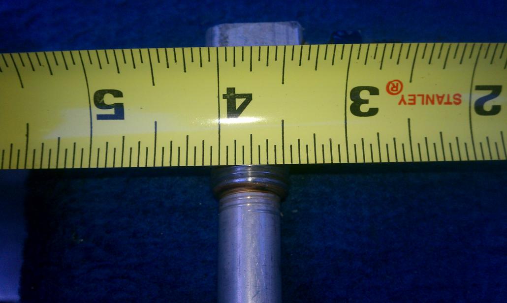

Okay here are some pictuers of the pickup tube, and 90 degree elbow. The smallest part of the whole assembly is the long pickup tube section with the screen on it. It measures 1/2 inch O.D. Should I have a larger pickup butt welded to the bottom of the 90 degree fitting. Everything else it pretty big.
