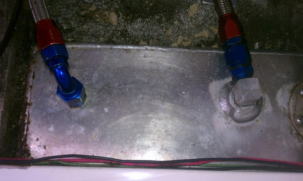

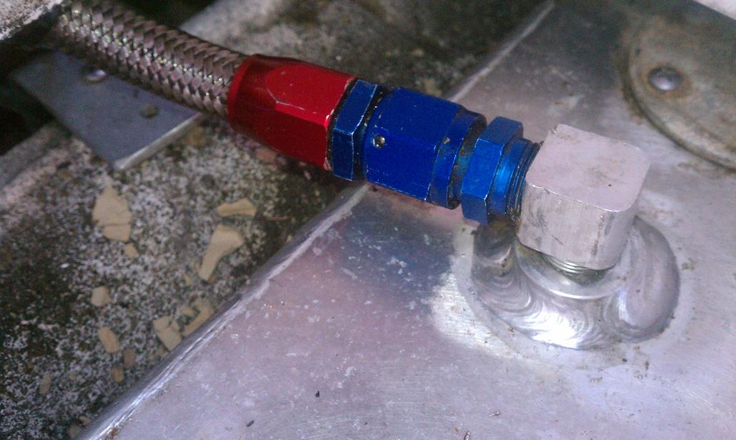

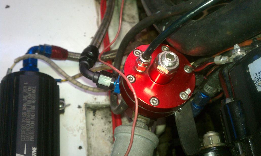

Okay, I brought this boat home last Saturday after purchasing it. I had a chance to go over it some more this am, and can speak with some more accuracy. The boat does have the procharger regulater on it. It also has what appears to be a custom pickup from the tank (bigger) and it get returned to the tank as well. It's all big lines not sure on exact size, I am going to try to figure that out. They are earls fittings. I am going to attach some pics of this as well. The computer is definitely the mefi3. Also found a small procharger module that taps into a temp sensor and the factory harness as well. It called a ect signal conditioner. Would I unhook this module if I had ecu tuned for bigger injectors and the 7/8 pounds of boost? Which regulater should I be running on this setup with the tuned ecu and bigger injectors? Are is the rest of my fuel system up the task? My 5 pound pulley measures 4.25, and the other pulley that came Withe the boat measures 3.75. Will that smaller pulley put be into the 7/8 pound range? Photos coming!
