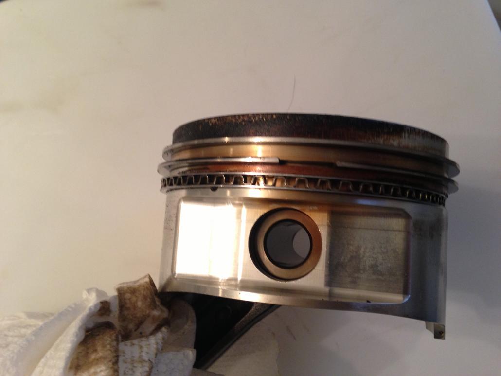

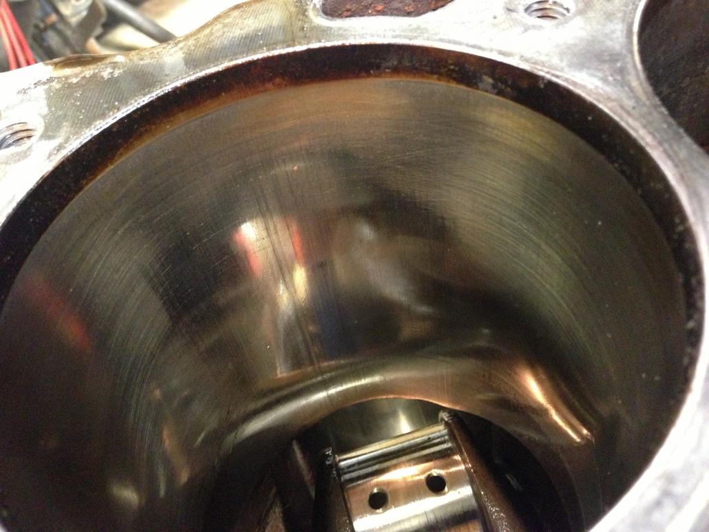

That's a little more than; running rich. Without actually seeing the rings, it is hard to tell. The 502s had a issue with oil control, or you are sucking oil from the intake valve. How are the deposits on the stem side of the intake valve? Clean your rings off and shoot a pic from the side so, we can see the rings and also the cylinder bore.

Sorry about the piston, if see now it was not the stock one.
The intake valve, deposits are normal for something that is tired. I expected to see worst.
The rings look like they are doing their job, 2nd ring shows the shinny area on the bottom 1/2 of the ring. Deposits at 2nd ring lang, not showing much blow-by from top.
The cylinder bore, shows all the cross hatch, gone in the thrust area. How many hours since last rebuild?
Can you measure, the piston to cylinder wall clearance, check the bore for taper and excessive wear areas?
Check your ring end gap, top ring then check the 2 nd ring gap. Just curious, to see what they are.
