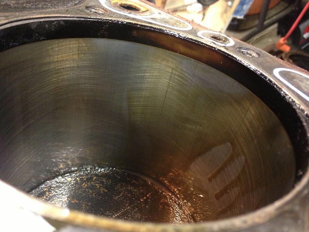

Thanks for your help, I ordered a bore gauge and digital caliper today to hopefully see where I end up. My original goal was to rering and rebearing the engine while figuring out what I have. Turns out whomever installed the intake manifold gasket completely destroyed it going in causing a massive intake leak on cyl 5 as well as letting water into block. Either over this current winter or prior to my ownership the cyl sat with water in it causing it to pit badly. So I'm either going to sleeve it or get a new block. On to engine 2.
I broke down #2 tonight and found out its a much newer block and has been rebuilt much more recently. Cross hatch is completely in tack with almost no wear. even the pistons look much better. Maybe it froze and a new block was installed. Casting number shows its an early gen 6 block (doesnt have 6 bolt timing cover)
I was running 87 octane with timing set at a base of 8 degrees. Should I have had much more timing and 91/93?

i hope you ordered a sunnen bore gauge lol...all bs aside,your best bet is to take it to a machine shop and have it checked,,i still see cross hatch from the honeing stones at the top of the cylinders..if you dont have a big ridge then you can most likely get away with rings and bearings but if it were me i would do the whole ball of wax which is a full bore hone line bore decking..you dont know what they been through so why not..or just wait for a nice pair in the swap shop..as a fact their are a couple nice pair on their.

Haha, I don't have sunnen type money. I believe the honing set that I use is sunnen though. Depending on the condition of the block I may scrap it and find a early gen 6 to match the other. One had water sitting in the cyl causing it to pit. So it's either a sleeve or used block so I don't have to buy new pistons. I'm very apprehensive of bringing anything to a machine shop because of having no control of their work. When I worked in one I took care to make sure everything was perfect, my coworker, not so much. Time will tell what happens. I'm currently writing Bob in help of getting myself a set of cams that may work with my set up. At least one of the two engines is in decent shape. Pic is of engine #2
