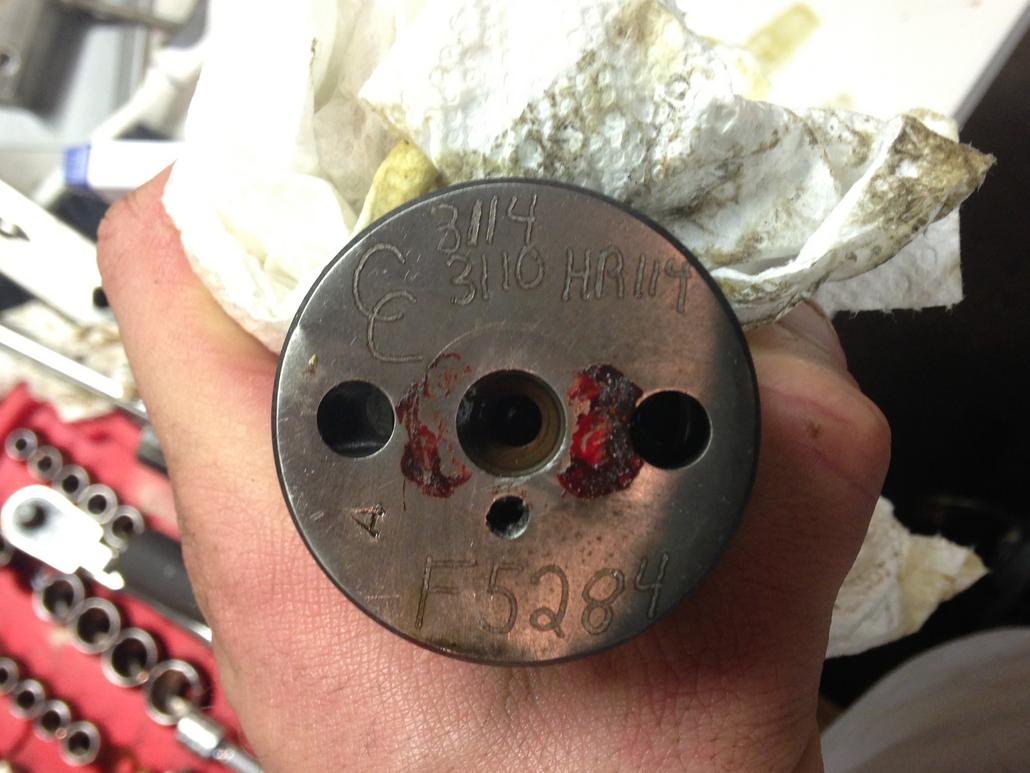

Cam - CC 3114 3110 HR114 and F5284 engraved into end and 139516 95C2B stamped into cam near one of the lobes.

the cam is a comp cams hyd roller,call them with the numbers and they will tell you what it is.

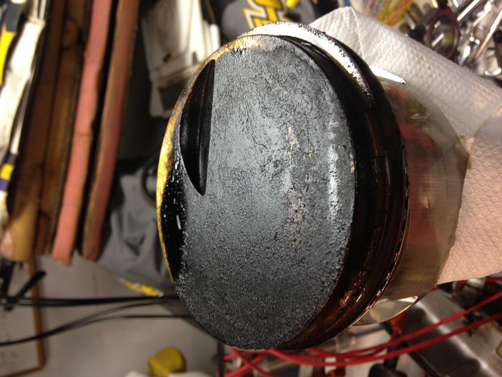

can you post a pic of the top of a piston.

Running a bit rich

because of the carbon buildup it is hard to tell if it is a flat top or has a small dome.
Flat

probibally not set up for supercharger,but could work for a lower boost setup,normally a j&e blower piston will have .300 or more distance from the top of piston to top of first ringland,also the wristpin for forced induction is a .180 wall pin.

looks like a stock 502 mag piston,,someone may have cur a deeper valve relief.. and like mike said its a comp cam,,looks loke a custom grind,,they stamp the mass produced ones..
