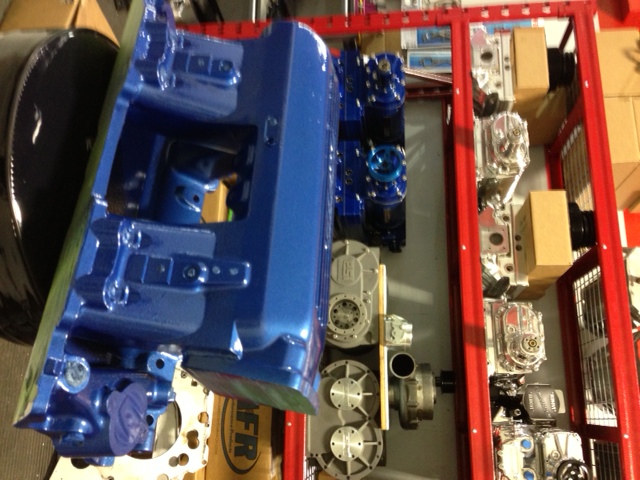

I used one on a budget procharged 489 a couple years ago. It made 850hp with low profile Imco's (which have a smaller ID), and two 90's. I ran waste fire DIS with a 58x wheel.
[ATTACH=CONFIG]530334[/ATTACH][ATTACH=CONFIG]530335[/ATTACH][ATTACH=CONFIG]530336[/ATTACH]
