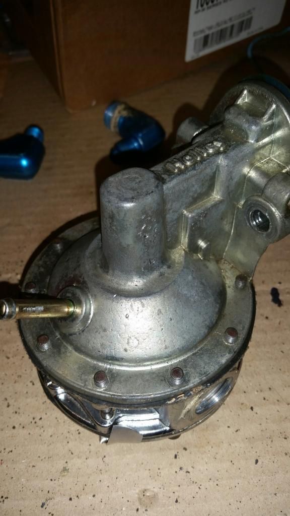

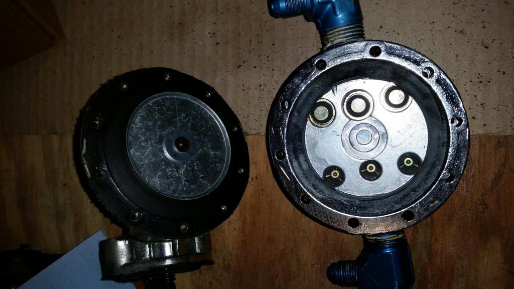

OK, found the pump that I was running on my 454. I had taken the bottom half off of it to inspect it, and from looking at it, it appears to be one of the 6-valve pumps. MT, Black Baja, is this the pump I want to run?
Is there a way to test these pumps? I reassembled it, but noticed that it is very hard to press the arm in on it. I know they have a pretty heavy spring, but should it be this stiff? I bolted it along with the leftover pushrod back onto my old 454 shortblock that I still have laying around, and spun the crank by hand with my finger over the inlet. I could not really feel any suction against my finger, but suspect that I may need to spin it much faster than this.
Anyone else have any ideas for testing it? It was working fine when I took it off that engine, but since I had it apart I would like to test it before going to all the trouble of bolting hanging upside down and bolting it up to my engine.

Yes, the arm should be very hard to move.

Thats the pump i feed a pair of 850 holleys on my engines and my buddy feeds a pair of 850s on top of his blown 540s. Try it and let us know how it works
