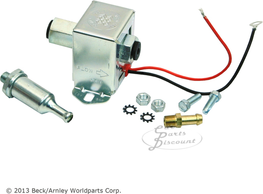

Budman, why is this pump on your XMAS list???
Attached Thumbnails Does prop slip increase or decrease with speed?  Top speed less than expected.-electric_fuel_pump_4_6_psi_oem_152_0584_1520584.jpg

[QUOTE=MILD THUNDER;4211278]Found the specs on that pump after digging all over.
50GPH flow at 6psi?
[url]http://fme
That research put some light on the whole conversation...
50 gph @ 6psi is not even a theorectical minimum.. and with 3/8 line's
http://forum.grumpysperformance.com/viewtopic.php?f=55&t=1939
Assume a BSFC of 0.55 and gasoline at 6.25 lbs/gallon: BFSC Brake Specific Fuel Consumption
horse power x 0.55 = pounds of fuel burned per hour
example
600hp x .55=330lbs
330lb /6.25lbs per gallon=52.8 gallons an hour minimum fuel used.....keep in mind pumping loss thru the lines , inertial loads and heat can easily reduce actual flow rates by more than 50% so if you require 50gph your unlikely to meet demand with less than a 100-120 gph pump even with the correct line sizes[/b]
