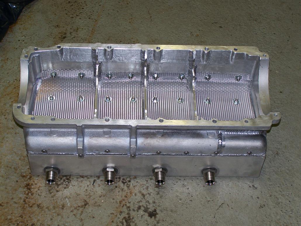

One of these will work[ATTACH=CONFIG]533137[/ATTACH][ATTACH=CONFIG]533138[/ATTACH][ATTACH=CONFIG]533139[/ATTACH]
I ran stock melling high volume oil pump with valve spring oilers with out a problem.
High volume oil pump at 70lbs will put the same amount of oil in the top end as a low volume oil pump at 70lbs.

16 - .040" holes is only .020 sq in. That's not much flow area. Like about a single 5/32" hole.
I ran no restrictors with the valve covers in the picture. Just had some big chief valve covers done with spring oilers by blp. If some one wants me to check the orifice on my new valve covers let me know.
