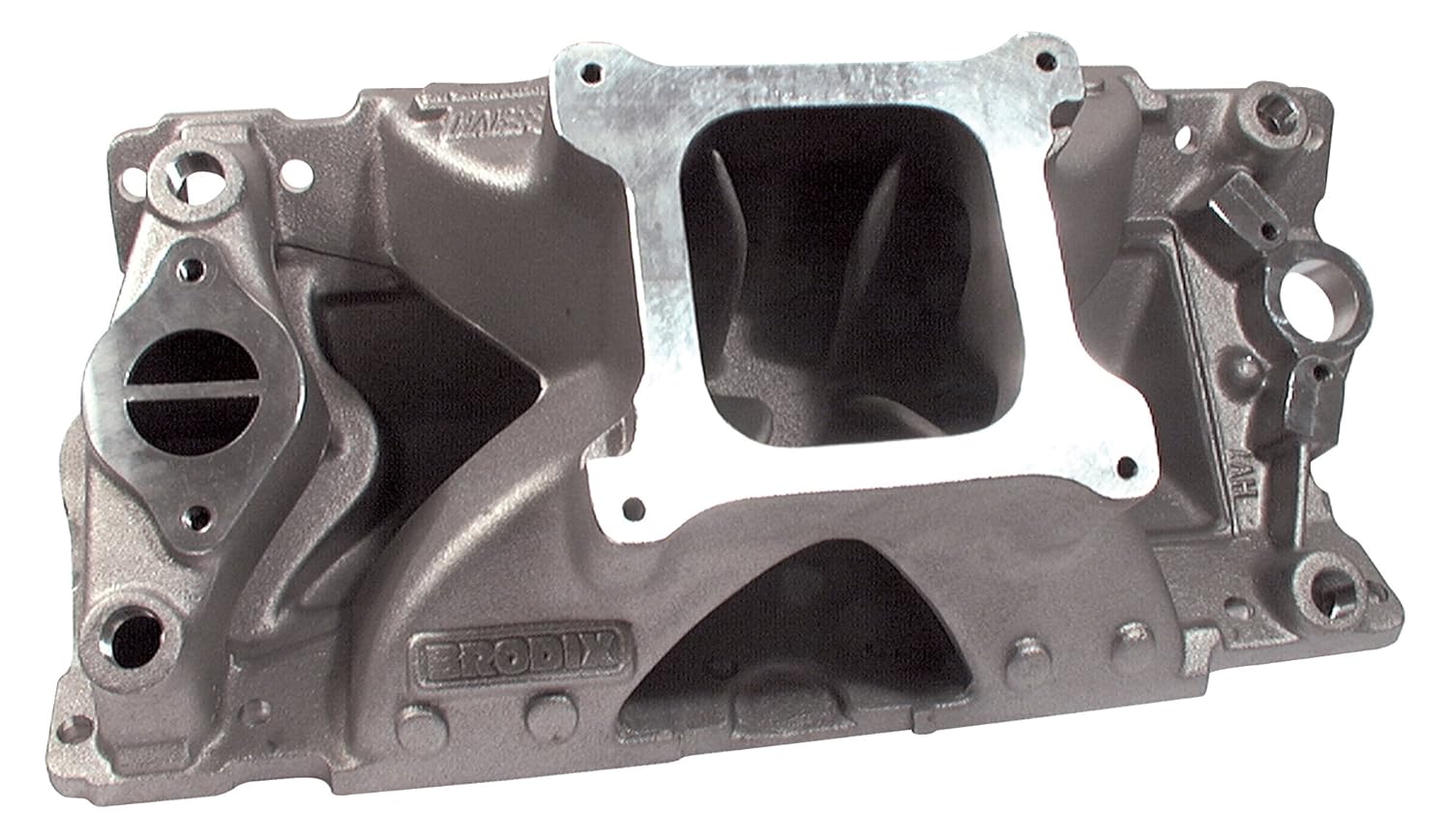

Originally Posted by Bawana
I have never seen a intake for a BBC that wasn't blocked off in the back... If you know of one... can you show me it? Or tell what they used them on. That would be a new one on me. I always drill and tap back there for water pressure sender, and have done both sides back there for steam pocket bleed offs.
I wasn't gonna go into that detail but since you asked.
Edit in: I see you mod your intakes for this too.
There's some intakes with threaded in ports just over these cyl head rear coolant ports so you can run water lines back to the t-stat housing. Some come with bosses you must drill and tap to do this. Some don't have the option at all.
Here's one intake with the drilled/tapped bosses (from the manufacturer) for rear water outlet.
And another:
