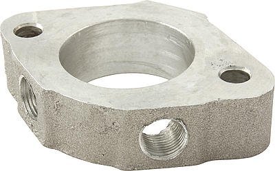

Run water lines from rear ports of intake manifold to a water block like Brodix's MSWT-4WT with thermostat between block and intake.
http://www.summitracing.com/search/p...ibution-blocks
