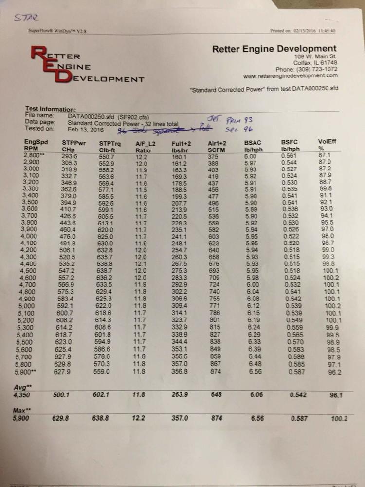

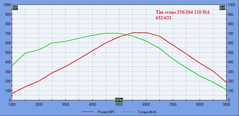

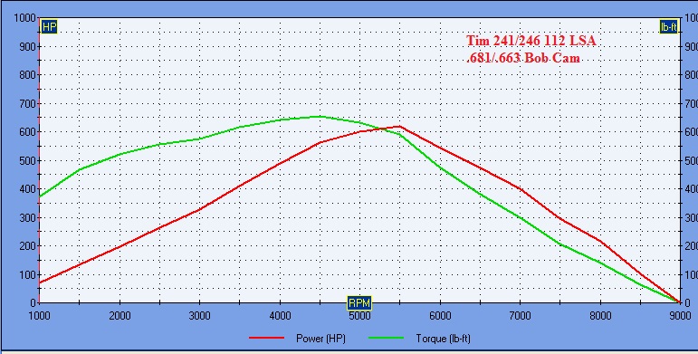

Tim, in reference to my post #131, I played around with some dyno sims over a cup of coffee. First picture here, is your actual dyno sheet. Second, is the dyno simulator, with your build specs. Third and fourth, are with off the shelf crane cams, no other changes to the combo. We know what your cam specs are, and what your engines actually made. I put the cam specs in fairly comparable to what these guys claiming over 700HP on the other site are doing. Wow, would you believe, the dyno simulator also agrees with their claims. You sure you still need "smaller cams" in a N/A 540 looking to turn 6000rpm on the water?
And for the "torque is what spins the prop" crew, take a look at the torque output at 5500RPM. Which one you think will spin the bigger wheel?
