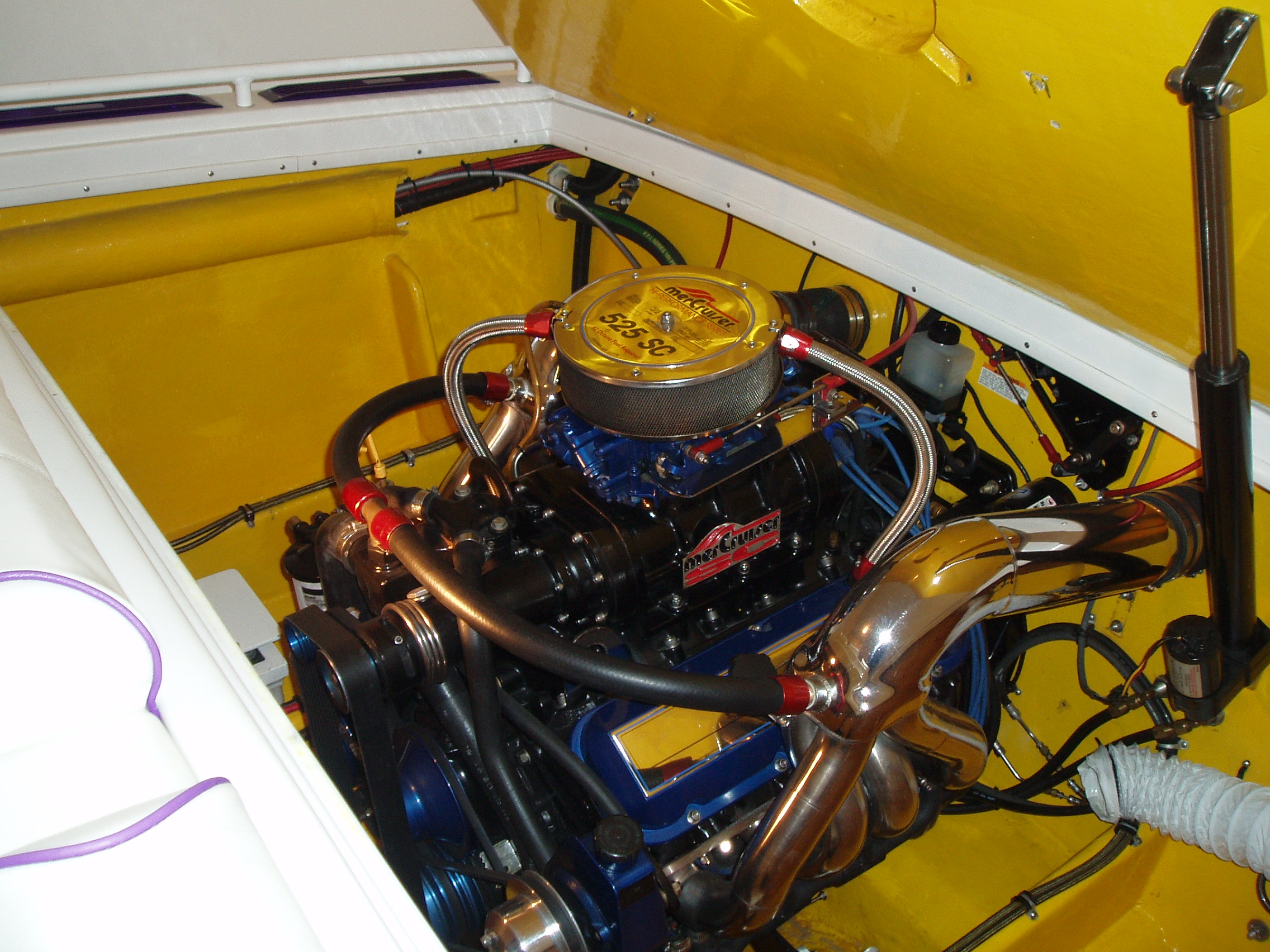

I would look into the pricing on the CMI Fusion (Unitop) headers. One piece E-Top header with no joint. I had them on my Pantera.
They are made for standard Bravo exhaust exit locations.
