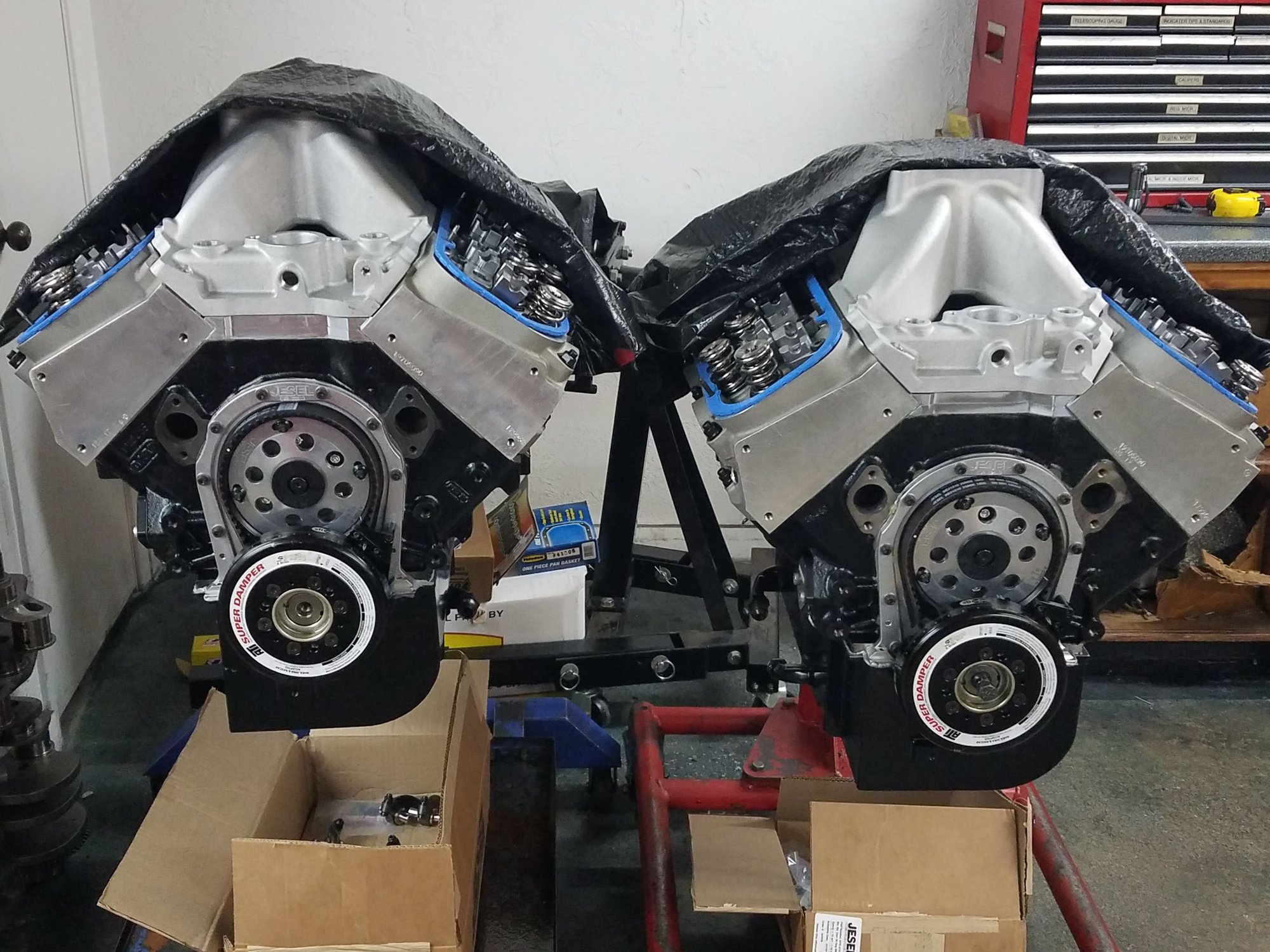

Just a little deck spacer
Single cat is offline

Did you have to cut the distributer pad down more to get the engagement rite and move the hole??

Yes and to cut it down some even though we have a slip collar.
