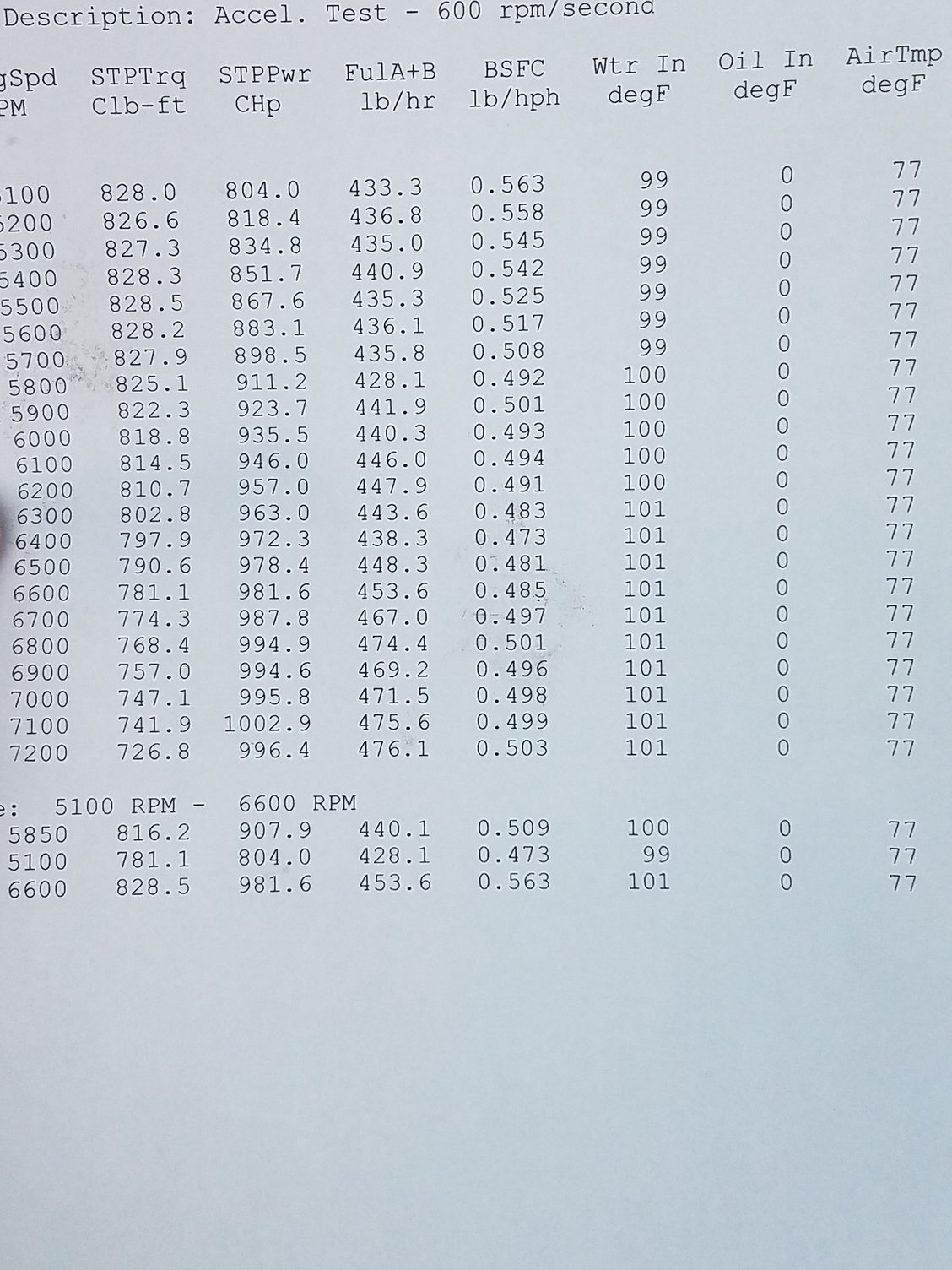

Third pull.

Last pull for the day. Got to put a little fuel in it. Thanks David Nickens for the killer engines and Jeff Harris for talking boat engine stuff throughout the builds. Just a 1000 hp on pump gas strait motor

Making some steam for sure! Looks like its not lacking torque with the big heads either. Did you guys do any pulls below 5k rpm?
I didnt think it would have made much power past 6500. Did you guys leave the lash to .022?
Great build, looks like your builder hit your goal

same csa as big 24* heads with a longer runner. Should make good torque due to longer runner.

yep. Goes back to the thoughts that runner volume isnt the end all to cylinder heads. Architecture is the key.
id love to see the numbers from 3500-5000. My guess is its making more than enough torque to get a 32 skater up and flying

We made one pull down at 4500 but i cant remember the numbers off the top of my head but it was mean. David add more water to the pump. He said he dont like pulling motors like that down low because its rough on his pump.
