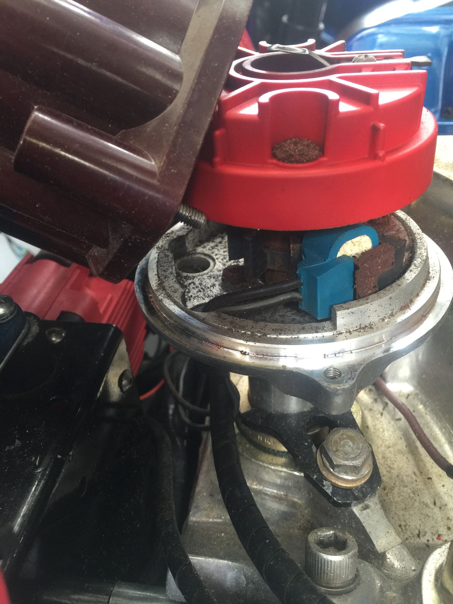

so, I think I found the problem... removed the distributor cap and this is what I found....

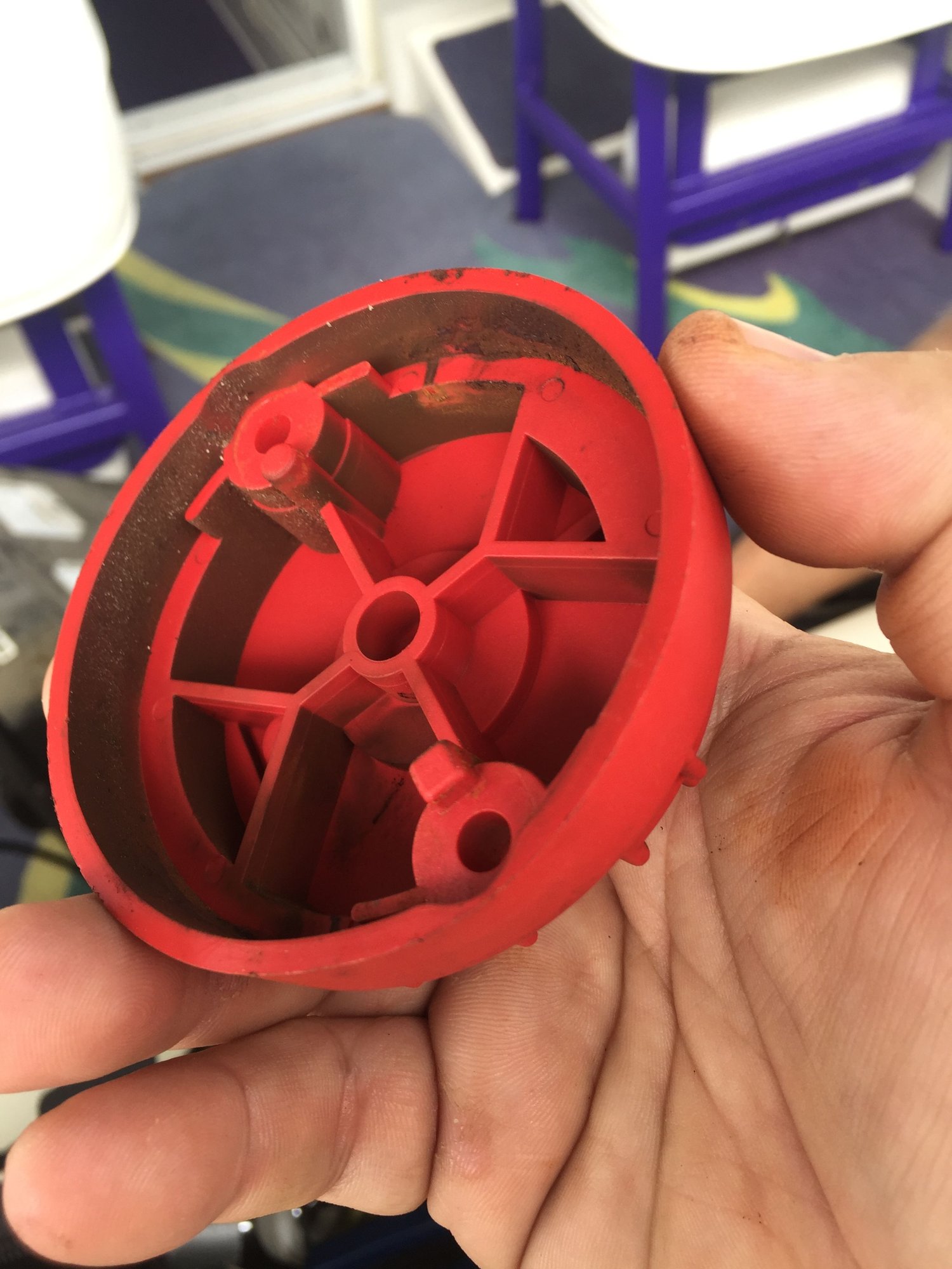

some additional debris in the bad one.... I assume its toast....
And here's what the other one looks like.... The "good" one....
So is it safe to say I need a couple new distributors??

So how many years has the MSD ,Marine distributors been horribly rusting and they haven't changed a thing ? 20? 25yrs ? More ?
My Sparks Disappeared
L\Do a search, MildThunder found a CRC spray that keeps corrosion away from inside these distributors. If you choose to stay with Many Schit Distributors.
