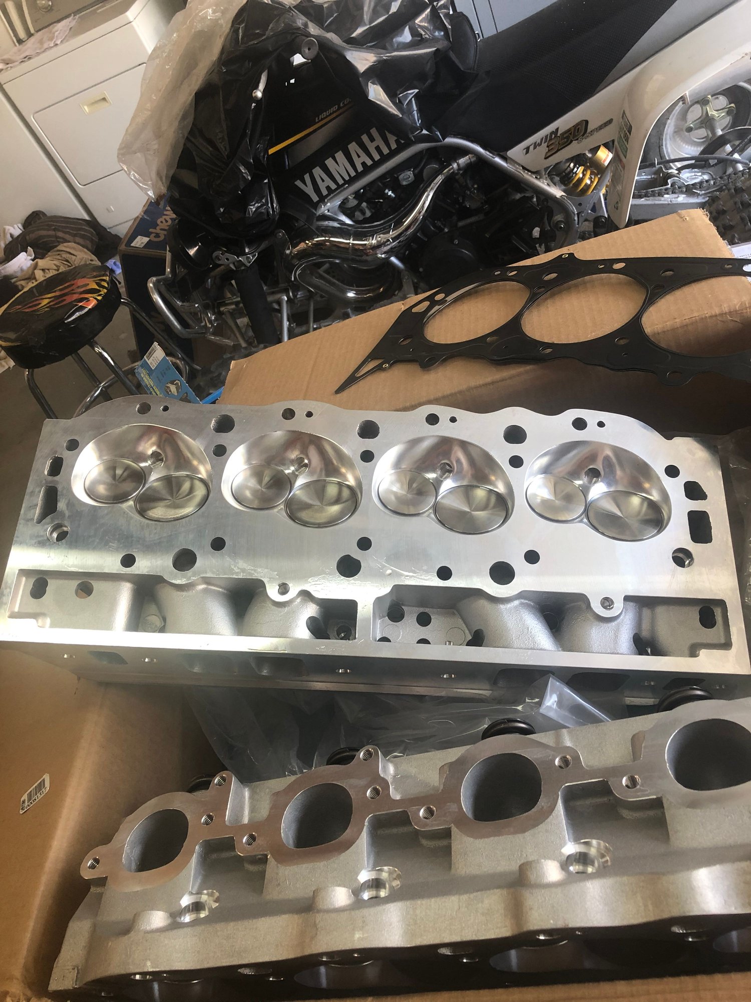

Water jackets are not matching up trying to figure out if AFR sent me wrong heads. Parts number is for a gen6
