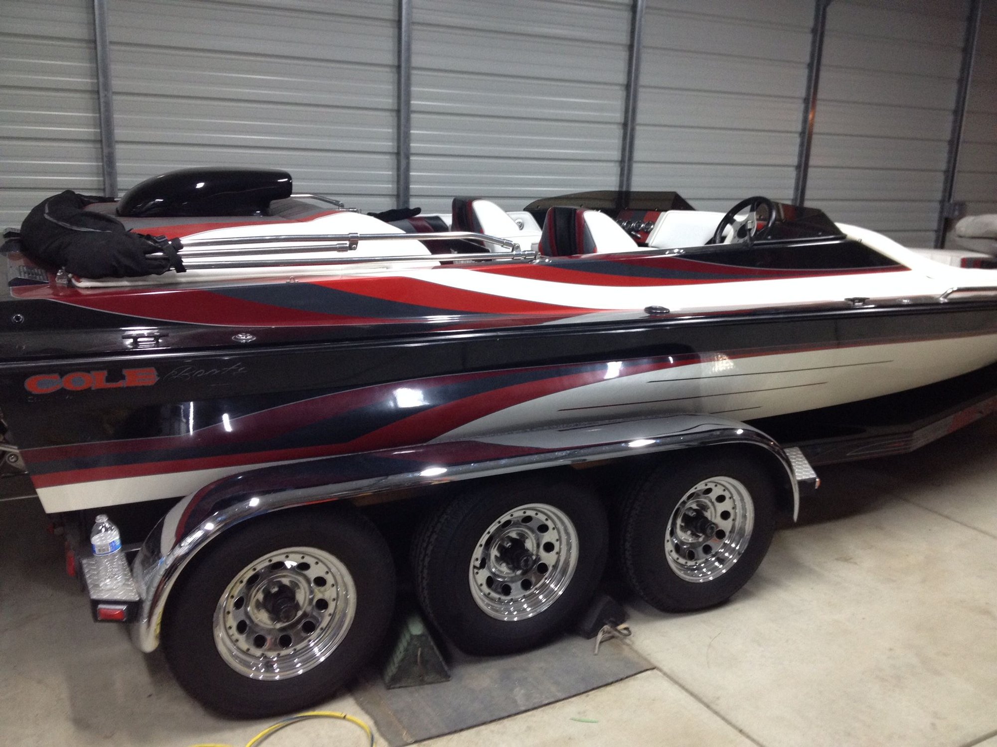

my goal was 630-650 HP in a 22’ boat should have it moving nicely

based on what I’m seeing I’d guess more in the 575 range at best fully dressed in marine trim with wet exhaust. What exhaust will be on it in the boat?
