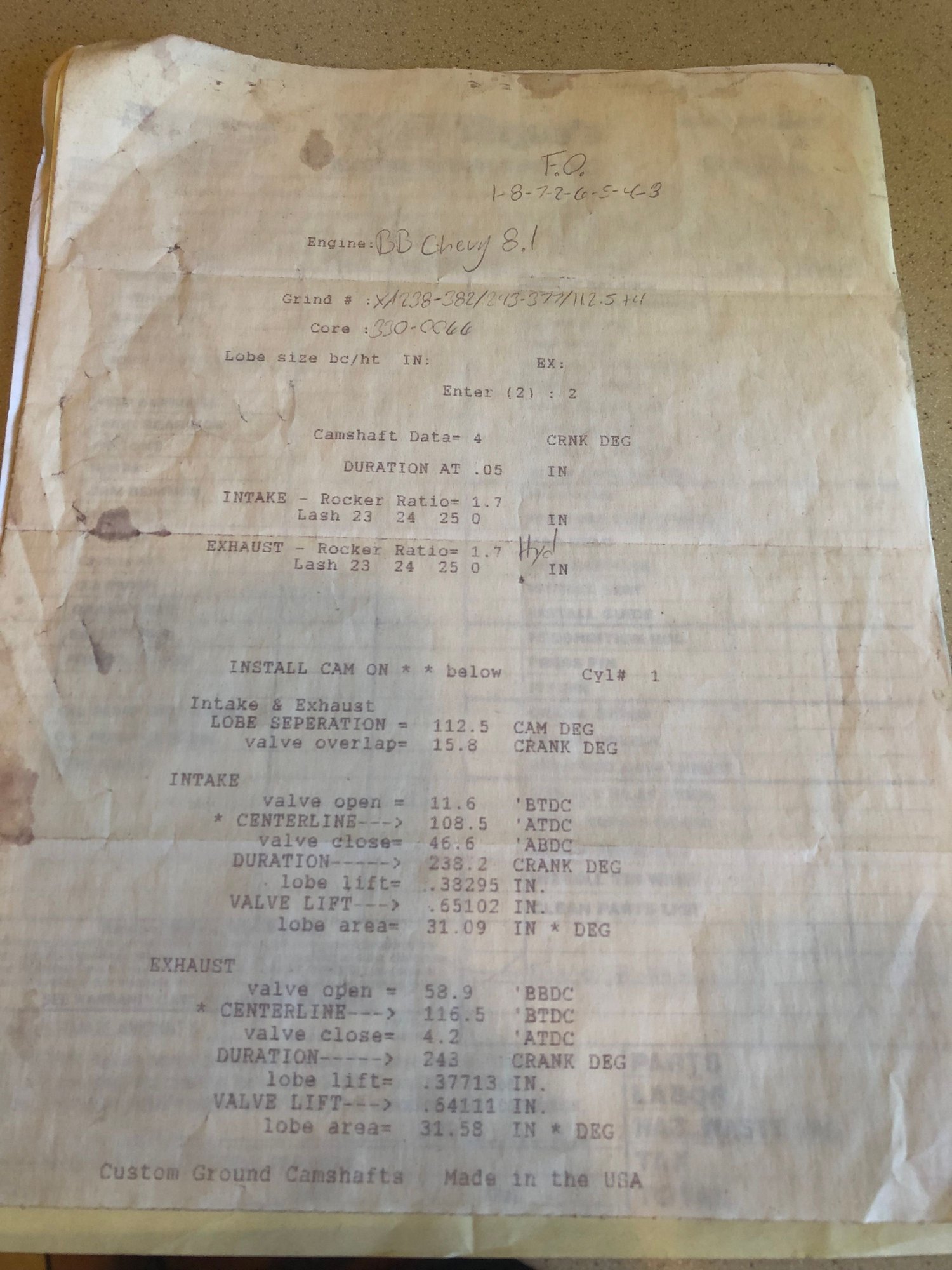

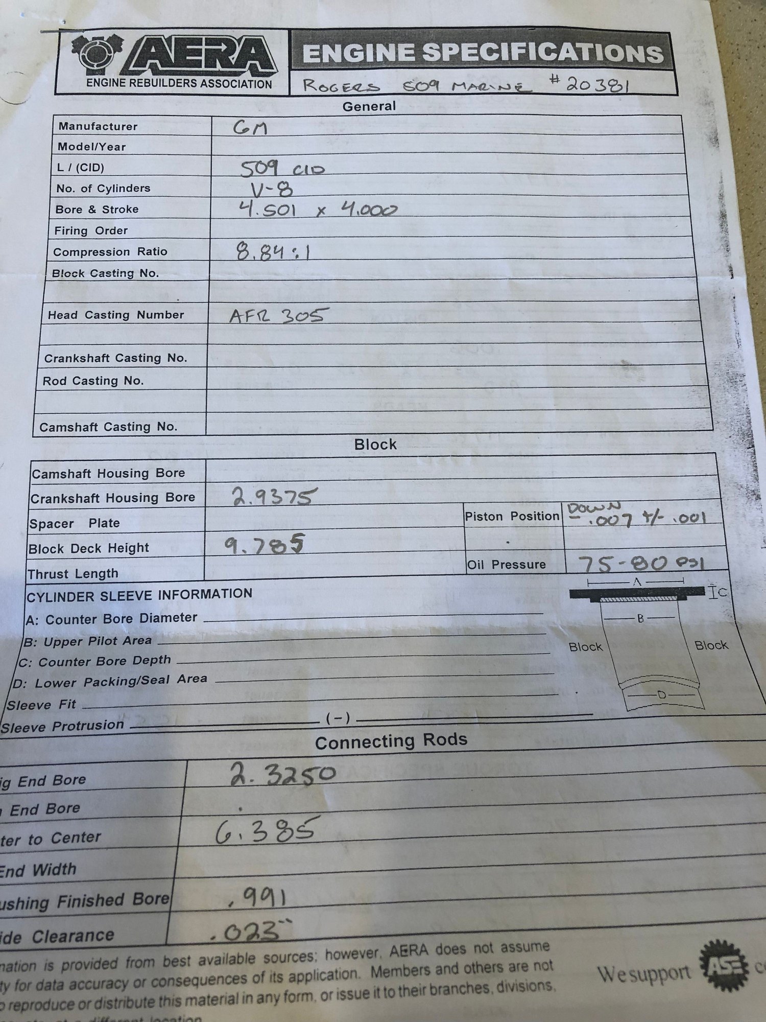

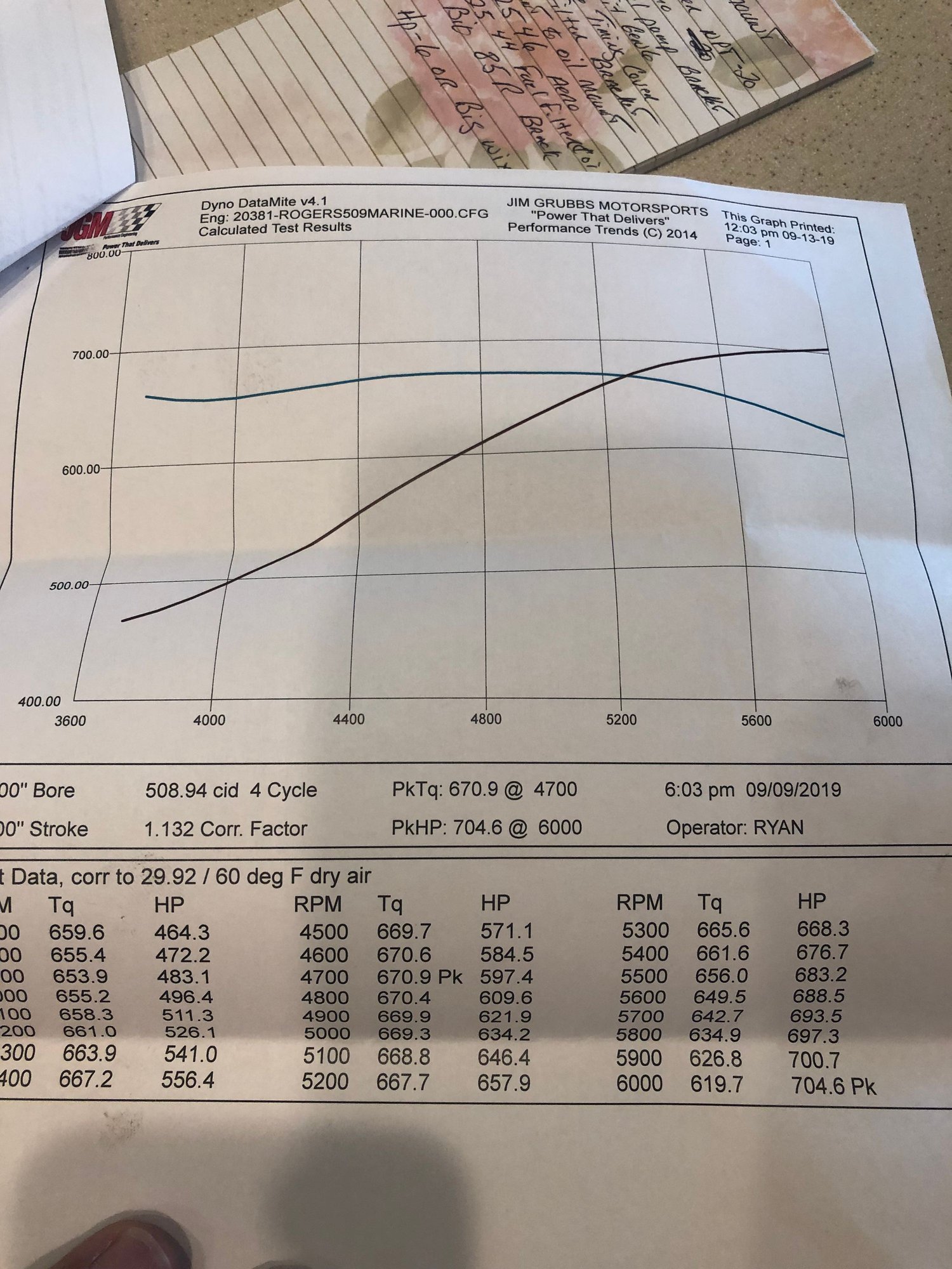

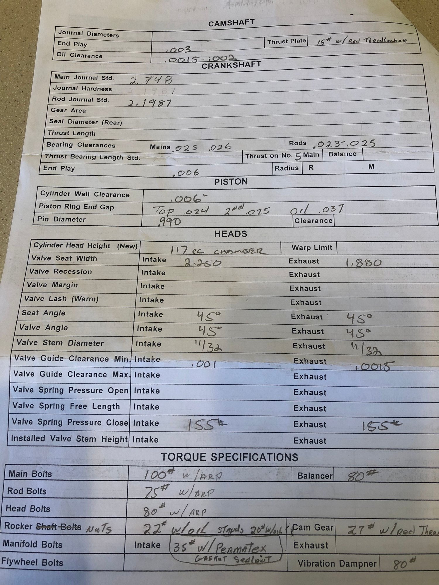

Old 09-20-2019 | 09:33 PM
  #75
Joined: Oct 2018
Posts: 36
From: California
Just finished up dyno last week 670TQ and 720 HP @6500RPM !! Thanks for all the help guys great advice. Now I’m running into issues with brackets who is a good choice to go with and areomotive A1000 fuel pumps pros cons ?? TIA

Originally Posted by Crude Intentions
Unless I missed it what was your final combo?
x2.
720 HP @6500RPM for a NA 502 I/O application is a schit ton. IE: More than a lot.

From: Merritt Island, FL
Do you have the sheets or curves? I would like to see what the TQ curve looks like.
