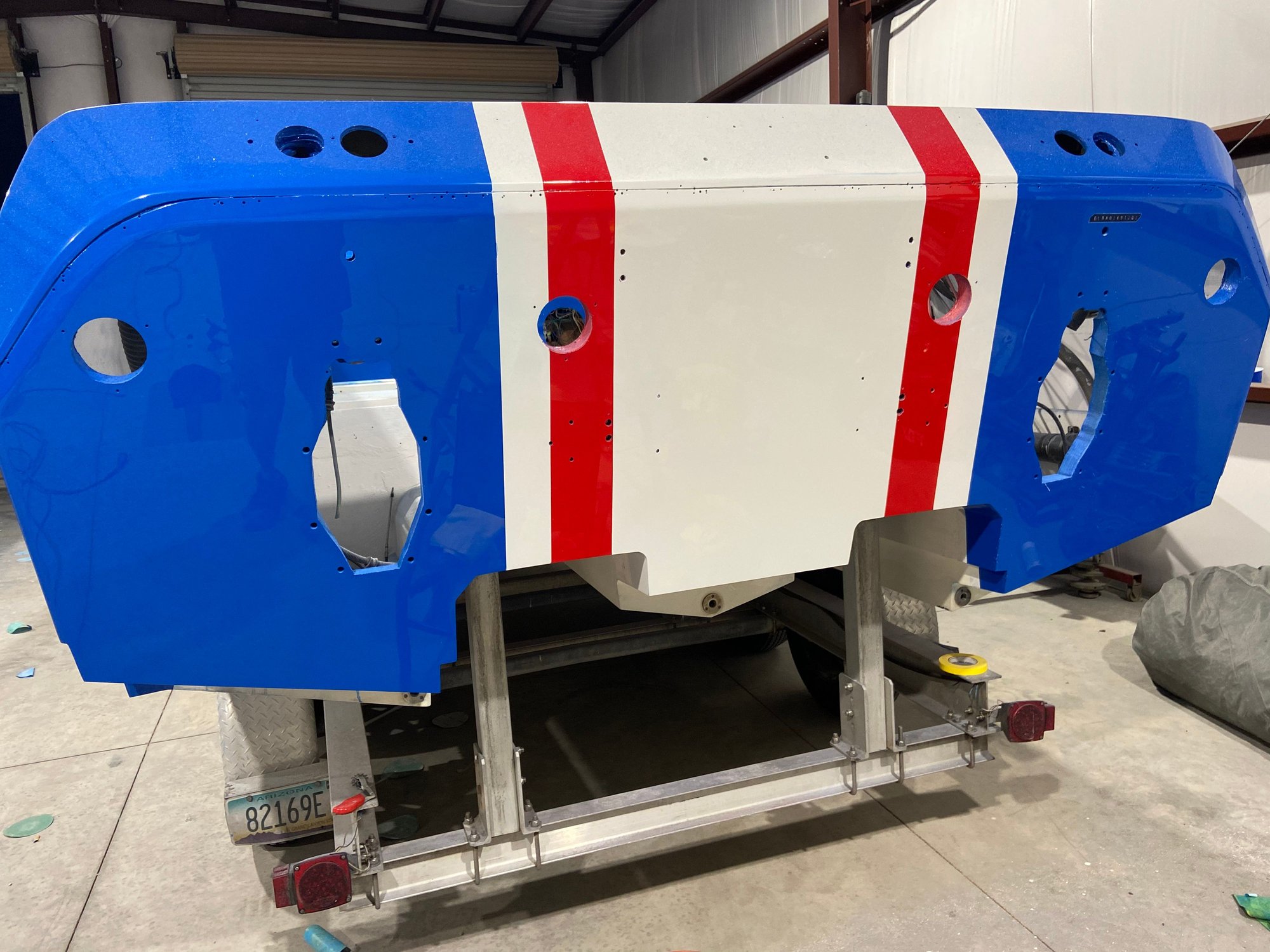

Not yet. Should be on water in 30 days or so. Just finished cut and buff below rub rail on paint job. Another week-week and half for top then back together she goes. Literally polished/powdercoated/reupolstered etc everything in boat. Full resto.

life. Its all finished up. Just havent had time to take it out. We went straight from that to my GTO repaint/ tremec tkx swap/ etc to my yard on my house. In the last month I built 1400ft of pipe fence, laid 4000sqft of grass, and about 200 tons of rock/dg. Finishing that up currently. I will update when we get it out. Maybe after holidays.
