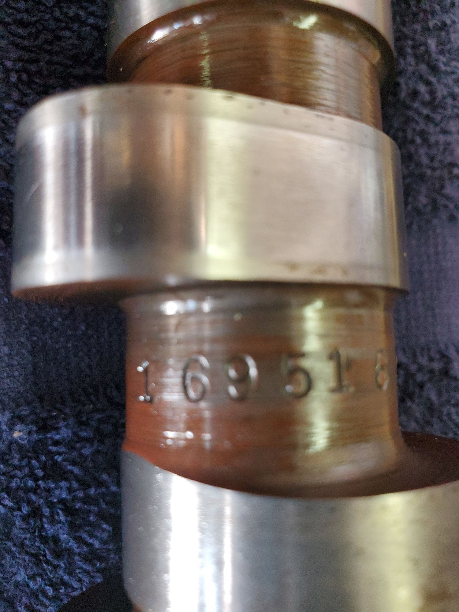

16951 98F2A this is stamped on the core
its in a Mercury 500 EFI looks to be bone stock

ttt.......I think its got a digit missing 169651 ?

What is engraved and/or stamped on the end(s) of the cam ?

maybe an X210 ?? I can read 98 for the yr
on the 165621 cam it has mhp-301 16-52-00 = 16th day 52nd week of 2000

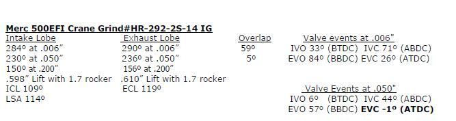

From my notes

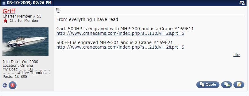

See:
anyone ever heard of a MHP-301 cam??
Maybe answers this ?
And another good deciphering read:
Help Identify this 500EFI Cam??
Edit in: and below:

thanks for all the info, when I pull the other engine apart I hope it will solve the puzzle.
