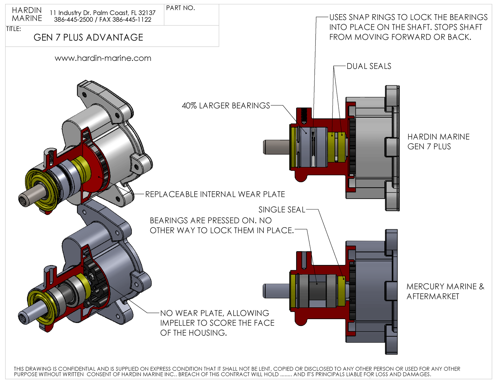

LS1 02-24-2020 04:02 PM
Here's some new info on the new Gen 7 Plus pump Hardin just came out with.
https://cimg2.ibsrv.net/gimg/www.off...49bc29f6c0.jpg
New Gen 7 Plus pump
https://cimg8.ibsrv.net/gimg/www.off...27603f5bf3.png
Advantages of new Gen 7 Plus
