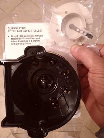

Originally Posted by BUP
I am talking about Mercruiser stock set ups and its even posted on their ignition part kits listing the application per what that states. I am passing on OEM MERC info. Here I just pulled the Merc kit and what Merc recommends even on their package. PIC in the next reply.
I know what it says(mercs not the only copper post cap source) ,i've used that rotor on caps from napa,autozone,advanced and it fits and works.I usually tell people to ask for a cap from a 93 gmc bbc.
