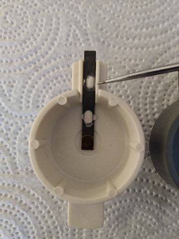

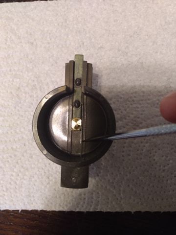

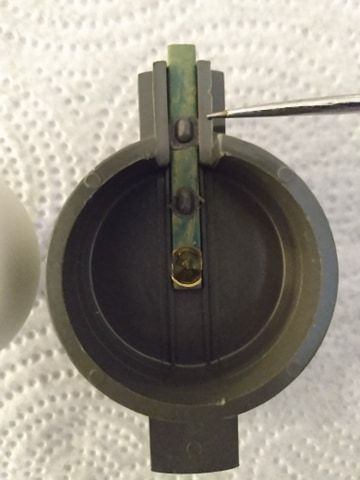

here is what I did with the rotors. The white rotor inwhich is not a bad rotor in this pic but here is what I done for a improved design the dark color rotor in the second pic below. . You can see the differences in the pics. Some beefier frame work and supporting the actual rotor itself.
Joined: Jul 2011
Posts: 9,594
Likes: 45
From: Ft. Worth TX
channel supports for the rotor itself. This keeps it straight and no movement. That's the issue I was seeing on customers boats a lot of the times. Had to figure all this out. Anyways a good tech tip for checking the rotors and looking at quality and whats not.. I am trying to be a problem solver in the industry freakin one part at a time
