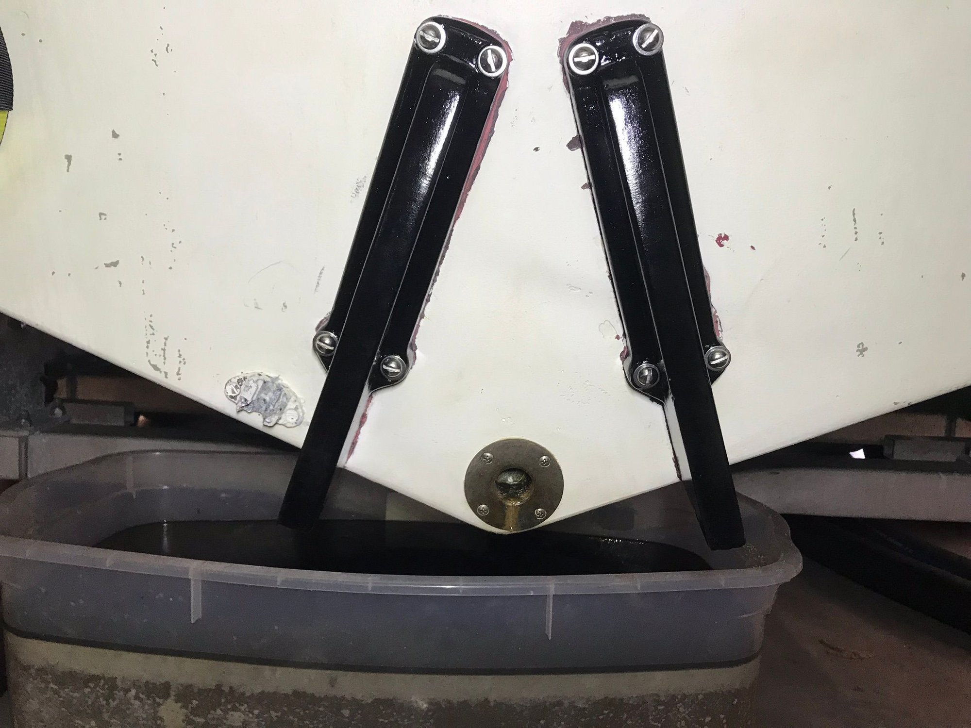

I mounted mine straight down because i did not want them to
inter fear with the drain plug

Mine are at an angle, so the pickups are perpendicular to the hull bottom. Flush with hull at the transom, angled down to 3/16” maybe 1/4 below at the rear. My boat is under 70mph so no water pressure issues

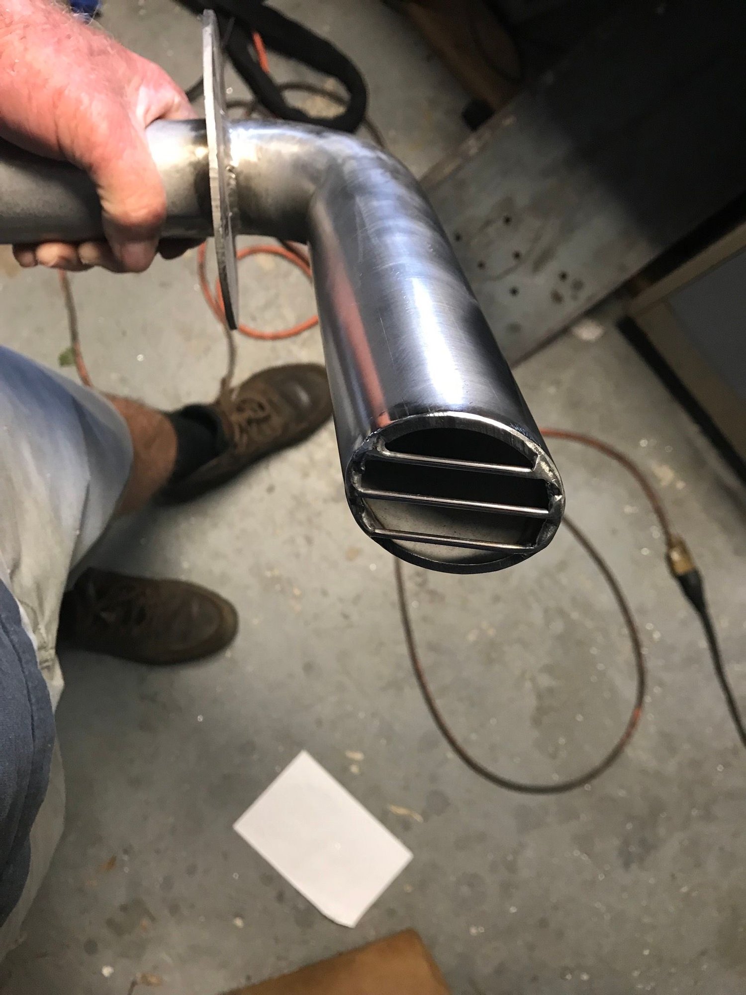

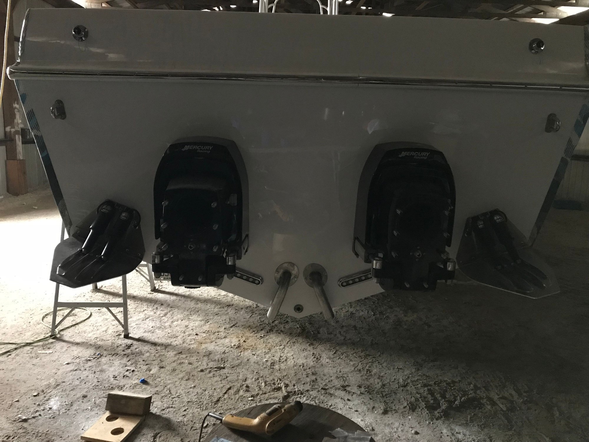

Probably not that critical for a single stage pump. However, as the previous post indicated, as you increase your pump capacity you may need to increase the supply.
These homemade ones are feeding three stage pumps that serves oil coolers, heat exch, and intercoolers separate
ly so they are oversized and flush in the leading edge with the trailing edge 3/16” low.
