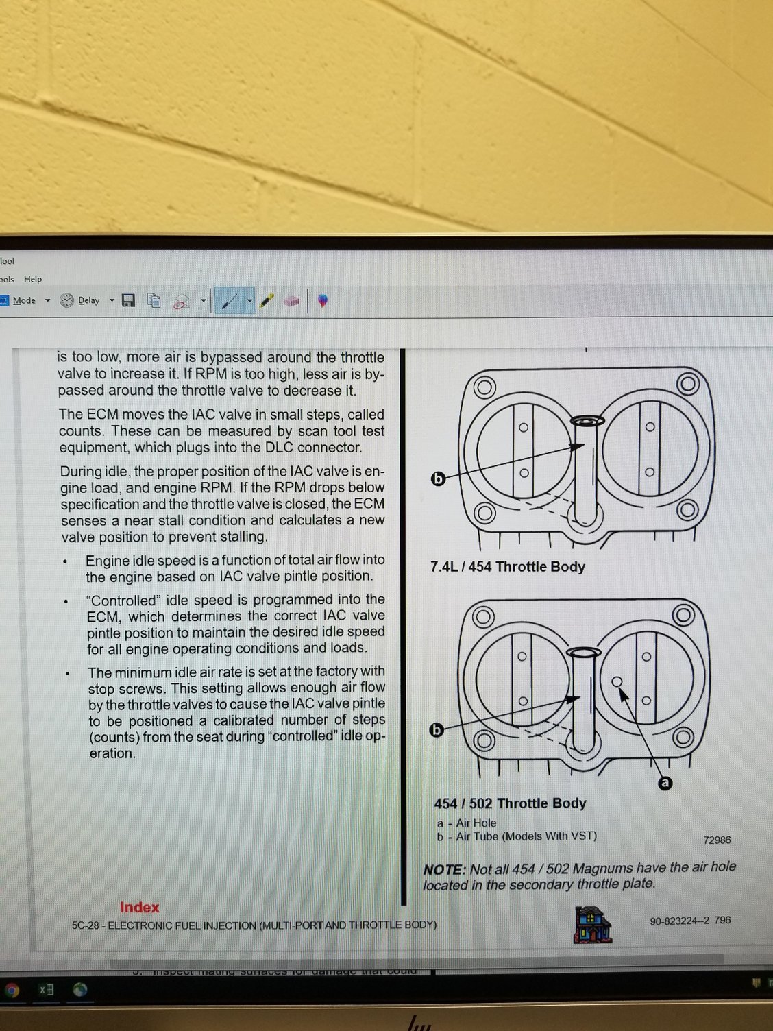

I noticed in the picture below it states not all mag engines have the throttle blade with a hole in it. Is there possibly slightly different parameters on a ecm tune for this difference?

In the tune there is a target rpm, iac minium position for restart, iac reset key up etc, You adjust minimum throttle blade position manually unitil your IAC counts on a scan tool warmed up are in the 30 to 40 range. Ive had to drill holes in TBs with big cams to get enough airflow for iac to have a good range and NOT have tb cracked open so far it send tps past its minimum range, ive had to plug holes. Your tune has ALL the stock idle characteristics a 502 uses as far as iac max, reset, etc for THAT style tb but fueling PW for a gen 6 cam . The extra 2 to 3% fuel it gets in higher rpm pw bands ISNT making it idle too high. These things are usually a combination of problems when looked at in person, when you said THIS, was it diling at the 1500? " When I put my finger over the air tube feedhorn the engine dies very quickly but when I put my finger over the hole in the throttle blade it idles smooth and clean at 650 700 rpm.", If so, adjust throttle blades closed more or run a very short screw, tight fitting screw in that hole with red loctite.
