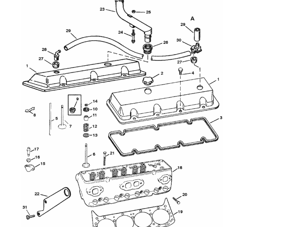

I have not had the injectors out or flowed. Never had a problem with them before. Technically I don't have a PCV just a elbow and baffle that are routed together but does let into the flame arrestor like the picture in the manual. The 5/16th line on the intake is already capped and has always been that way that I can remember.
