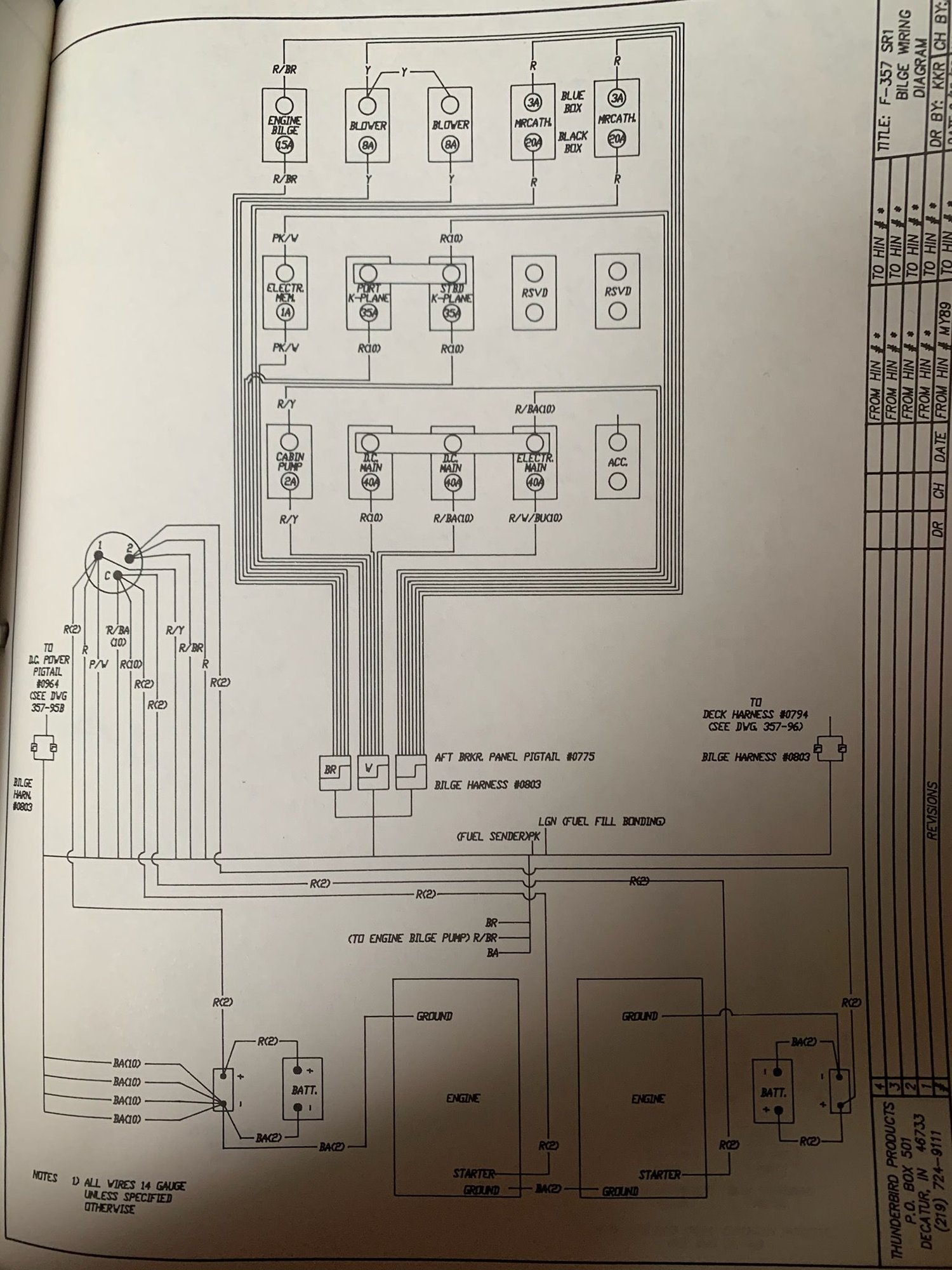

Quick Update,
We through all the connections from the batteries, bus bars, engine, barrel connectors, and up to the ignition switch. All tight and complete, no corrosion. One thing I did notice is the the Port Engine is slower cranking than the Startboard engine which I will diving into next but that got me thinking about SB's comments regarding the Perko switch, I am going to pull that apart and see how it is wired. Luckily I have the complete red book to guide me. Many of my past Formulas, you could use the trim switches with the keys and the batteries OFF, but this one - the keys and the battery need to be ON for functionality. I also ran through the fuel lines and carbs, everything was clean. The last check is the fuel vent and siphon valves.

Really great having all that information available, isn't it?
My electrical system works just the same. I need power on for the trailer functions to work, and ignition powered on to operate the individual trim circuits.

Originally Posted by SB
No crank is electrical.
Are your battery switches in positions where the two motors are tied together, by any chance ? Share a ground ?
Ignition switches share a power wire or ground ?
Any stumble/misfire when you use outdrive from or trim tabs ?
well, the issue switched back to the starboard engine. Only issue that I have noticed outside of the stumble is that the port engine is slower to crank, my cockpit speakers have become really distorted and all the gauges dip when I hit the trim switches while underway. Looks like I’m chasing a lose connection. The only thing I haven’t checked is inside of the Perko switch. I’ll be digging into it tomorrow.
Perko switches do go bad. Most of the time they are riveted together. Just replaced on last week.
