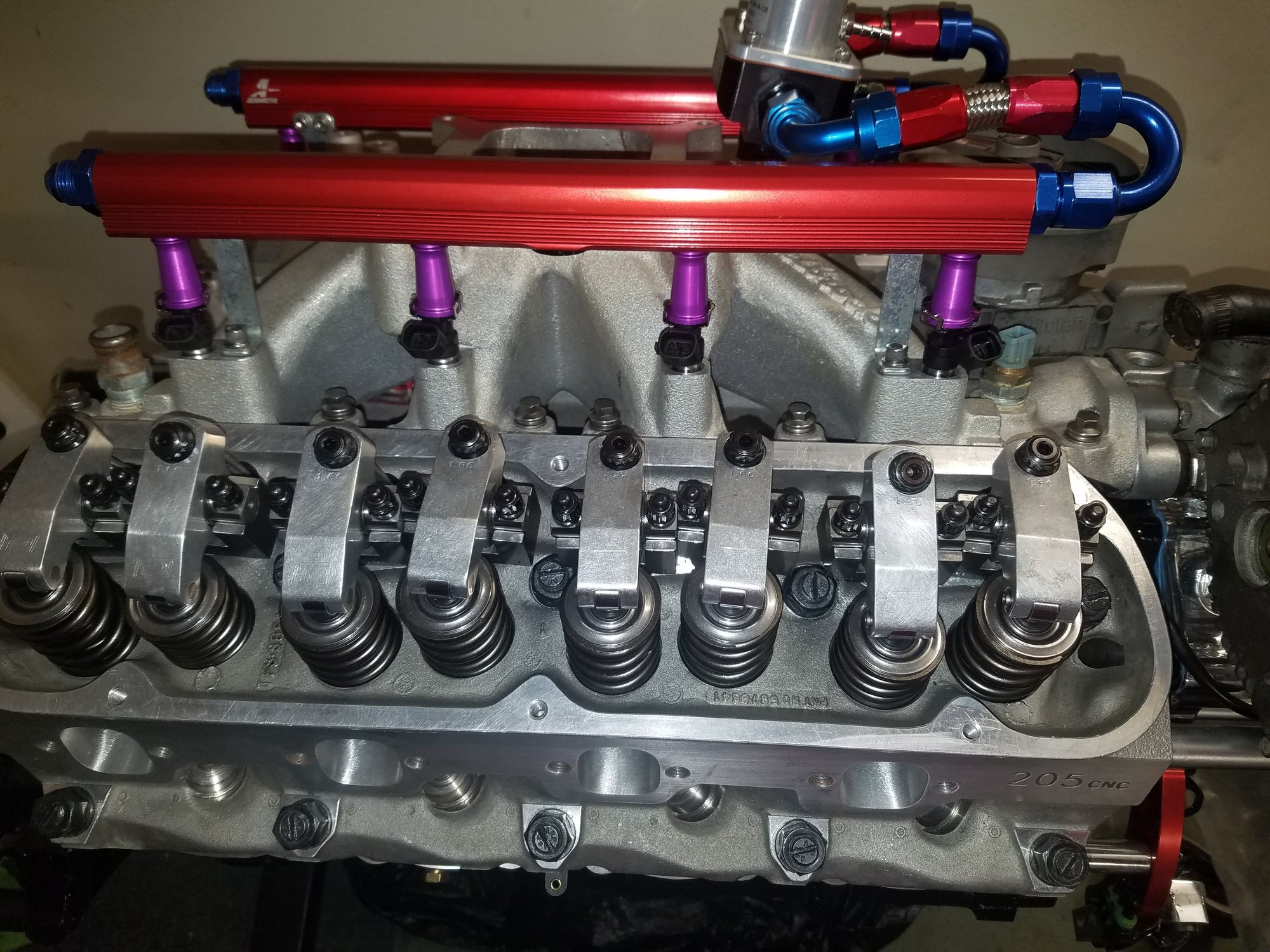

This seems to add credence to the theory that oil isn't draining back down from top side of heads quick enough. You can "gasket match" (using old head gasket) the oil return holes in head to same holes in block to see how well they align. I've heard of people "moving" the holes slightly to improve alignment. I may be off in left field here, but it's a quick and easy thing to verify/eliminate.
Just realized this is a Ford which I have very little experience with. Don't they have oil return passages at front and back of head? Hard to tell from the pics.
Yes this is a sbf. I know I'm an outsider here 🙃. I do run a bbc in the boat though. There are a lot of very smart members here that I hope someone would catch something that was missed.
The sbf head drain back holes leave something to be desired for sure. But I ran these heads and block for the last 10 years with no issues, so I don't think that's the main problem. I ran the old engine to 7500 and never once seen smoke from it. The oil issue happens at low rpm also. I ran it at 1800rpm high idle and it was smoking like crazy. The oil covered valve picture was from after the high idle. I'm not saying the the drain backs couldn't use improving but the oil pump isn't flowing that much at 1800rpm to flow more than the drain back could handle. 7500rpm for an extended run like in a boat and it could definitely be an issue. The engine runs at wot about 9seconds max. The time to run the 1/4 mile. My typical cruise rpm on highway is around 2100. I would do that for miles at a time. Also ran heavier oil than the 5-30 on the working engine. The heavier oil should drain back slower.
Come to think of it, i think this problem happens when the engine warms up. Unless the oil is just burning more than, not sure.
Everyone please understand i am not arguing with anyone here. I really appreciate all the help you are giving. I'm hoping there is an ah hah moment that comes out of this thread. First builds were almost identical to the engine that ran for 10 years with no issue. That's what makes this so strange. Something definitely happened/ changed. Hoping I can find it before I give up, which is getting close.
I have a small thought that it could be something with the heads, don't know. That is one of the few parts that wasn't changed out over all these last builds. Again these heads had no issues prior. Not to say something didn't happen to them when they were freshened up. If i thought there was a good chance the heads were the problem, I would buy new ones. Issue with new heads is they don't make my exact ones anymore. The newer version was slightly different valve angles which won't line up with my pistons. Then I'm getting mixed answers if my current shaft rockers are compatible with the newer castings. If I need to buy both it would probably be another 4-5k so I'm holding back as of now. That's a lot of money just taking a guess.
You can sort of see one of the oil drain back holes in the lower right of the head.
Thanks for all the help so far.
