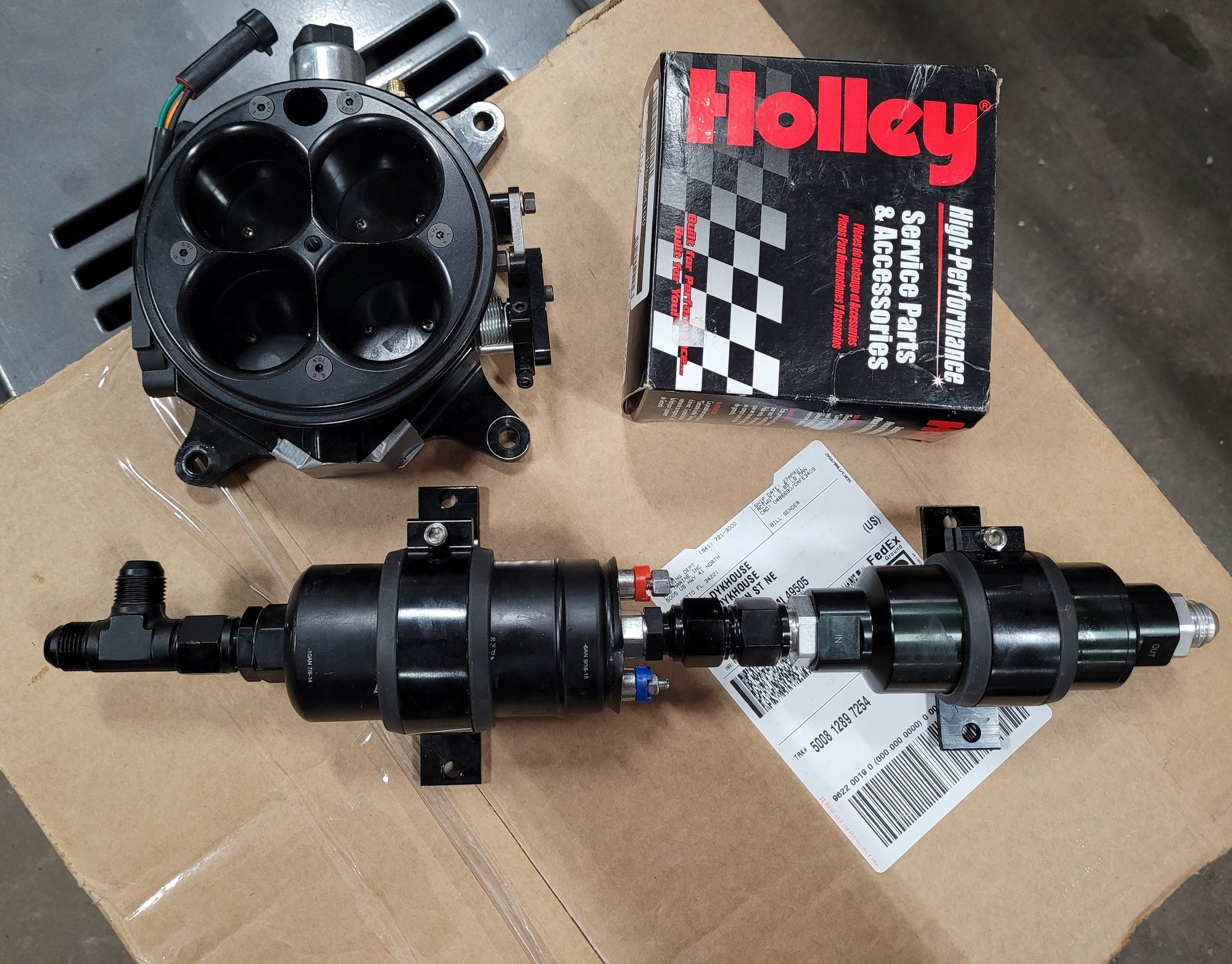

Old 05-04-2021 | 04:20 PM
Rookie's Avatar
Joined: Jan 2003
Posts: 6,018
Likes: 1,521
From: Grand Rapids, MI
Rookie is offline
