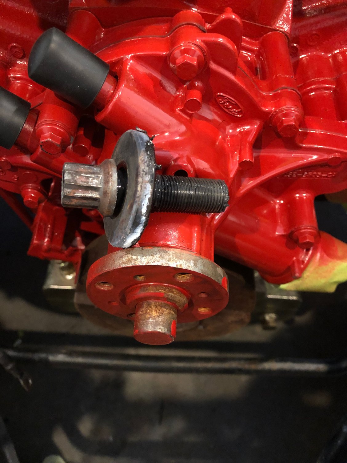

Sounds like you've thrown everything normal at it, and then some. I like that inertia socket from IR, or you need a torque multiplier.

I’m going back old school with some 1 1/2” square stock this afternoon. I’ll cut a 4 footer and put all I’ve got into it after heating up again. I’m pretty certain I’ll snap off the end of the breaker bar. 🤣

Drill the head off.
Pull balancer.
Remove bolt stub.

You need a heavy wall impact socket and that race track air impact. Get the bolt scary hot with your torch and then hit it with that impact. Scary hot means you think its on verge of melting. You won't melt it with map gas, but try, then hit with the impact with heavy wall socket. The thin wall ones suck. Did a side by side test with cordless impact and lug nuts. Thin wall would not budge them, two different impacts. Grabbed a "impact" socket and they came right off. Never thought it made a difference, it does!

Thanks very much Gabe for the offering. We gotta meet up sometime! I just got that stubborn ***** out. 💪
