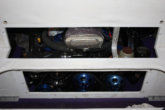

Hello
Still without a solution ...
Seen in a offer in Croatia, a twin engine Mercury 500 EFI with closed cooling...
Not very pretty, but it is equiped
