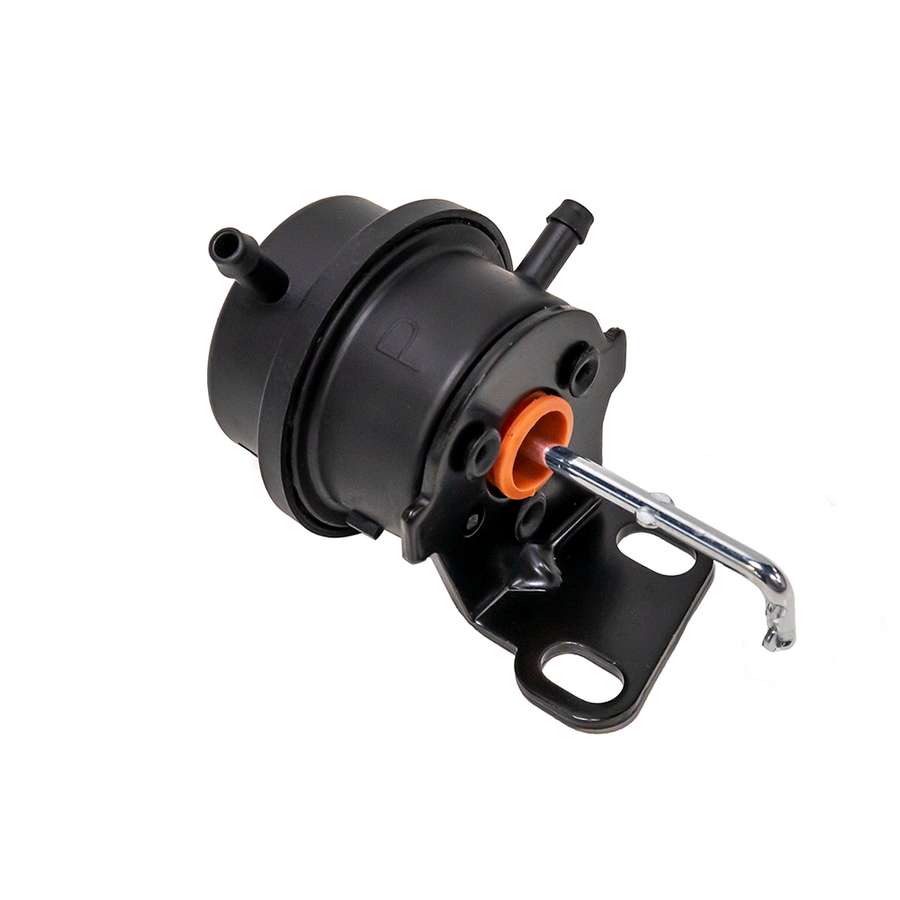

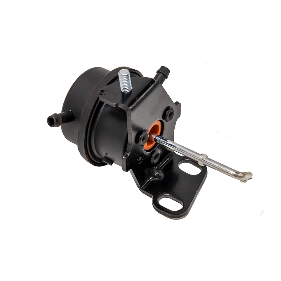

picked this from my Whipple install PDF,
Supercharger By-pass system. The supercharger is installed with a by-pass system. This allows the supercharger to operate at higher efficiency under vacuum operation. It is advised to verify the operation of the bypass valve. At idle and low engine loads, the bypass will be open. At higher loads (engine in boost) the bypass will be closed. As the throttle is opened quickly the bypass valve will close momentarily. This verifies the bypass will close and is functioning. Actuator failure could lead to intercooler fires, poor performance and erratic idle. If the actuator fails, it could have an air leak which will result in poor idle qualities. A failed actuator will also allow the bypass to open it’s internal butterfly during boost, which will circulate air and reduce airflow to the engine, consequently lowering the boost level and power
see if you have something that looks like this, these hook to a diaphragm with 2 other hoses that control vacuum while in boost........... I know your blowers are different

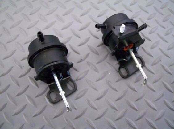

I just went through this late last season with my TCM1200 efi's. Poor idle that had a "blower surge" loading up with any amount of idling, fouling plugs etc. Tested my bypass vlaves and sure enough the diaphragms were blown, easy $300 fix. I was pulling my hair out thinking it was a MAP sensor or IAC which both tested good.

Sorry to step in, but man…,,that valve sure looks like the GM 3800 motor’s bypass valve found in:
- 97-08 Pontiac Grand Prix
- 96-03 Pontiac Bonneville SSEi
- 96-04 Buick Park Avenue Ultra
- 97-04 Buick Regal GS
- 04-05 Chevrolet Impala & Monte Carlo SS
- 95-99 Buick Riviera

Snd then this. They state they get from same manufacturer that supplies gm snd eaton with them. ??? $80
