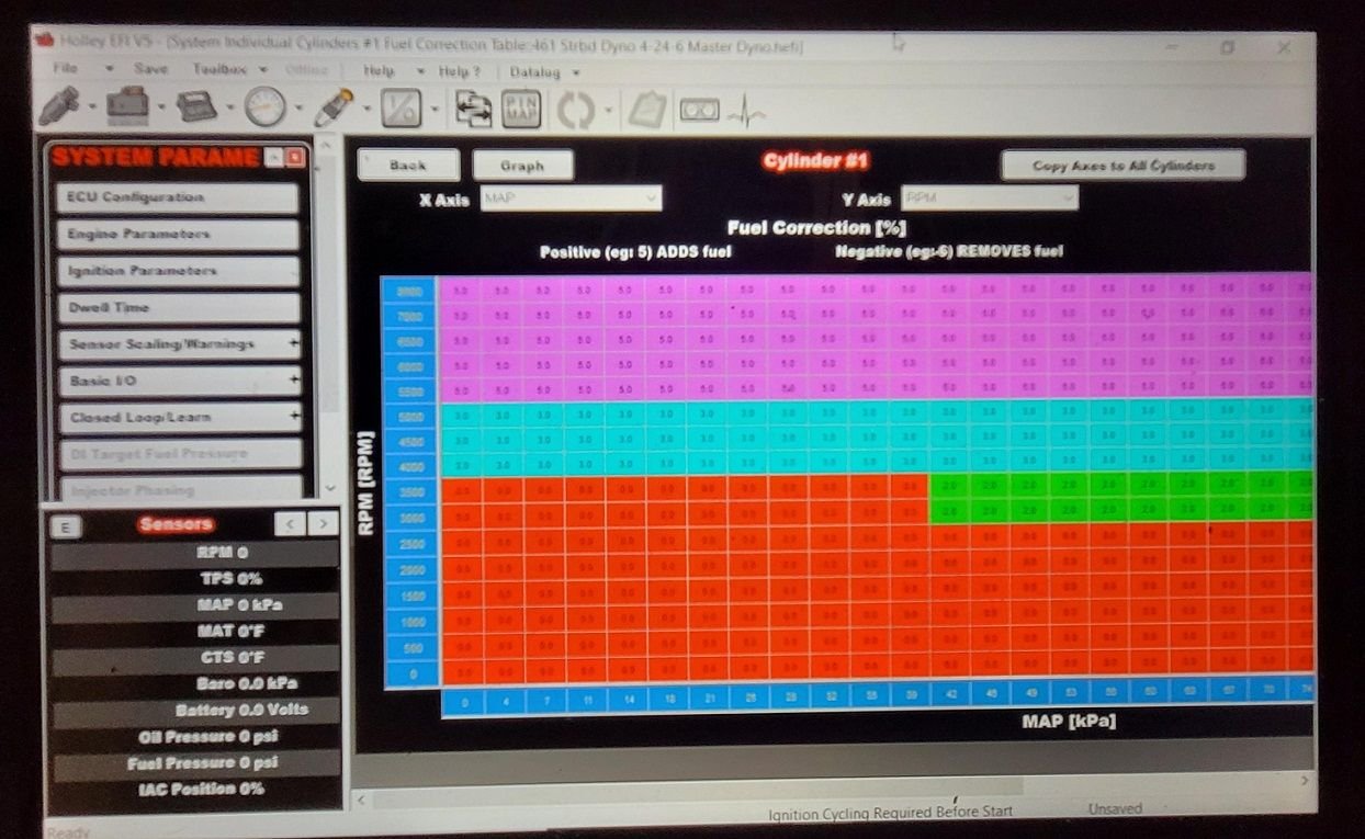

On Smitty's dyno (articfriends) with 8 O2's my engine AFR's was pretty close cylinder to cylinder. Just for the sake of doing it we tuned the 2 leanest cylinders down to follow the average. #7 cylinder was just 3% fuel above 4000RPM and #1 cylinder was graphed 2% @ 3000-4000RPM above 42KPA, 3% above 4000-5500RPM and 5% at 5500RPM+.
Timing can also be graphed in the same way.
