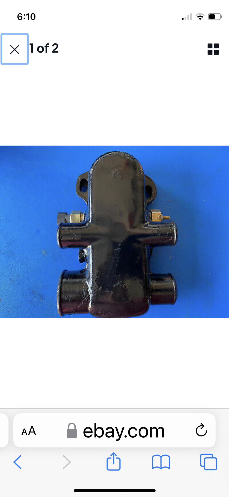

You can get the 4 hose tstat housing then. It has just 2 outs.It is found on 454/502mpi engines and some others.
Looks like this.

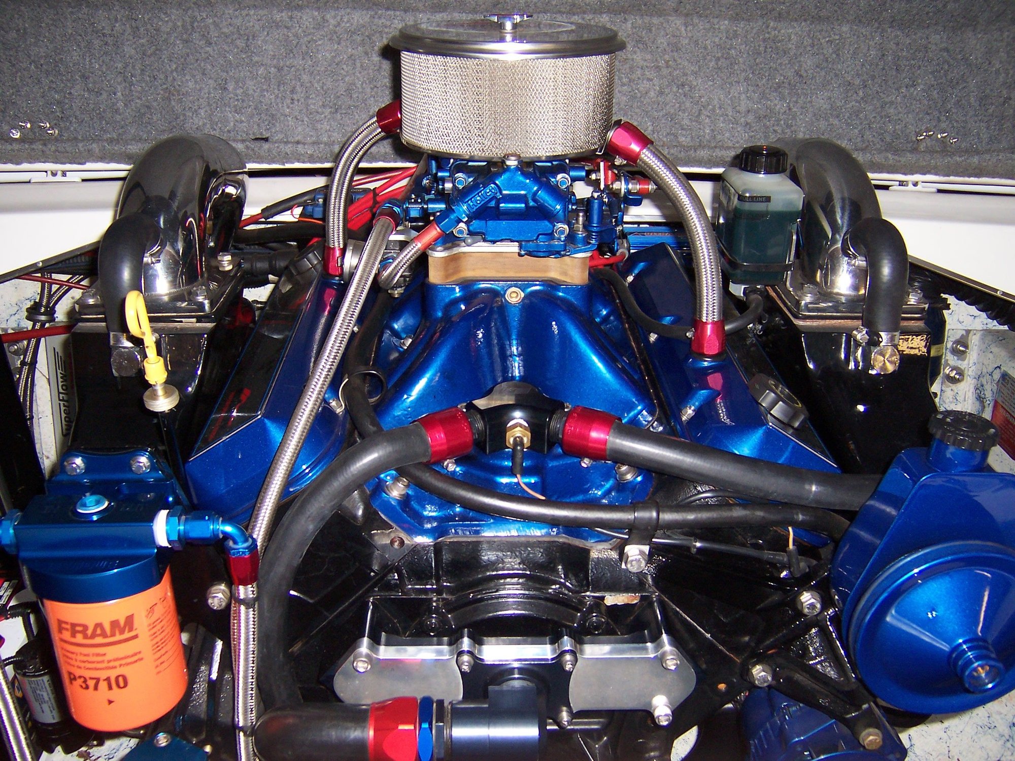

Post #4 shows my set up

Originally Posted by xlint89
Yup, that’s the setup I mentioned. Good pic :thumbs Looks nice :thumbs
