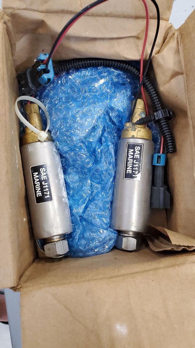

I have a couple used fuel pumps if you want to try them, changing them is a PITA one of mercury's better idea........
Thanks. Will keep that in mind. Stbd Pump replaced with aftermarket already, and new OEM regulator, still behaves exactly like Port. PITA for sure - did not enjoy the experience!
