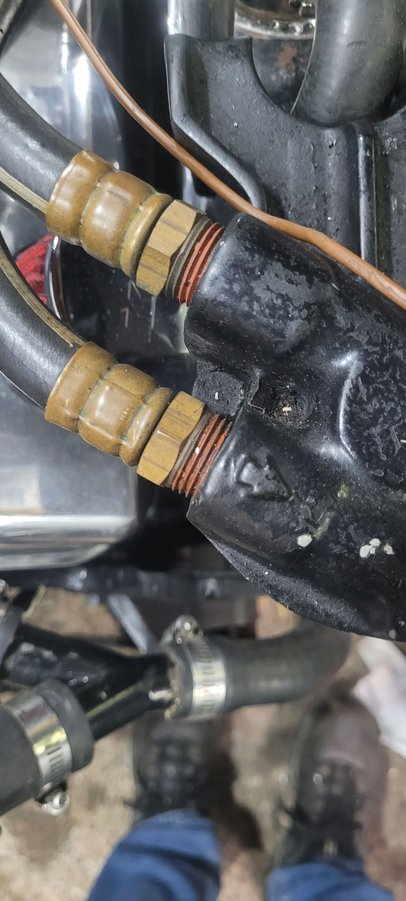

Originally Posted by JAbsher
My hoses are routed exactly like this. My number 17 hose is my outlet and my number five hose is my return.
Something is incorrect then. If you have the same oil filter adapter #5 hose is the inlet of the filter. There is an arrow on the adapter. The arrow is facing towards the adapter and the other hose is the out. Follow #5 back and you will see it comes from the block remote adapter. The arrow on the oil filter is the flow so if you have it reversed you maybe not getting oil correctly

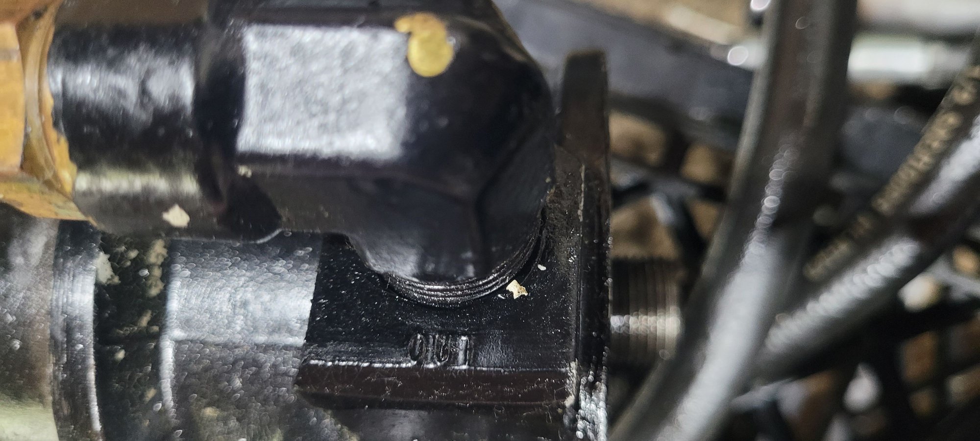

The hose that goes from the block adapter see pic .it says (out) goes to oil filter in------- follow arrow then out of filter to cooler
