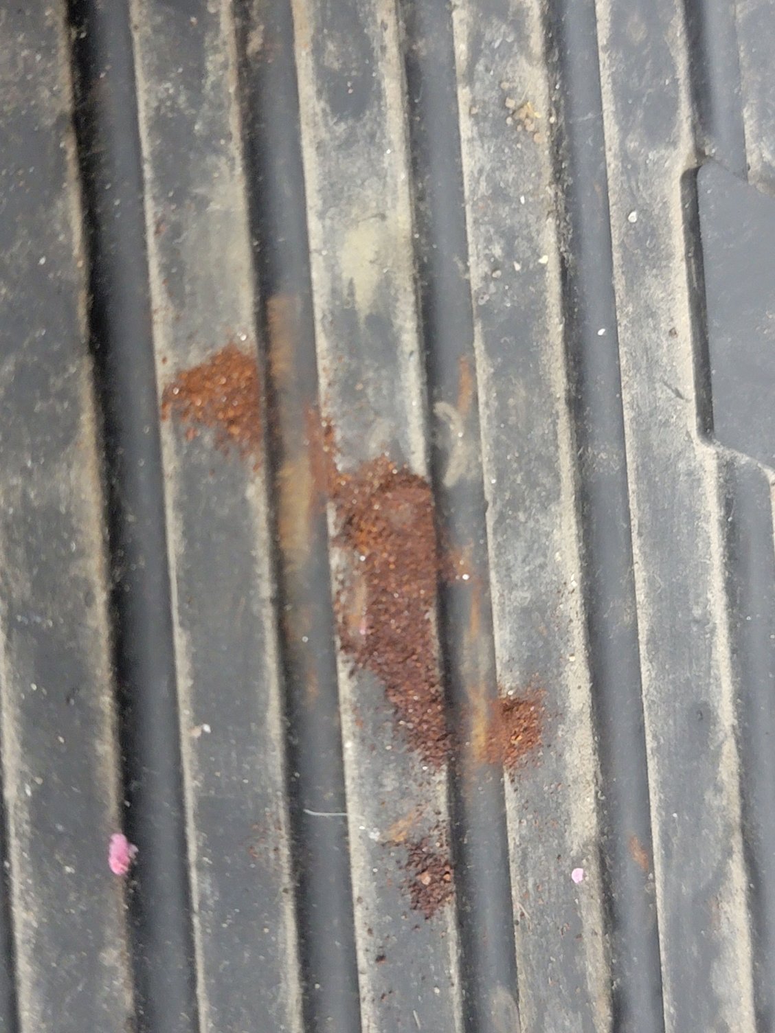

Edit in: i have pulled several water separators off boats that where internally rusty. Couple extremely rusty. I slways see what pours out when i change them.

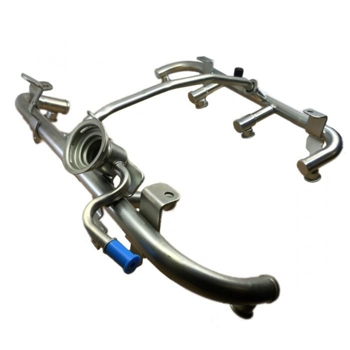

I see it on cars/trucks. Usually the injector that has it’s screen filled with rust junk first is the one at a dead end of a fuel rail. Like #7 cyl on a 5.3l ls powered truck for example. I’ll find pic of fuel line on intake.

I’ll take pic in a bit.Edit in: i have pulled several water separators off boats that where internally rusty. Couple extremely rusty. I slways see what pours out when i change them.

Okay, here is the 8.1/ 496 set up on intake. It’s configured similarly other ls truck deals. See how #7 (and some others) is at a dead head (in respect to flow) ?
