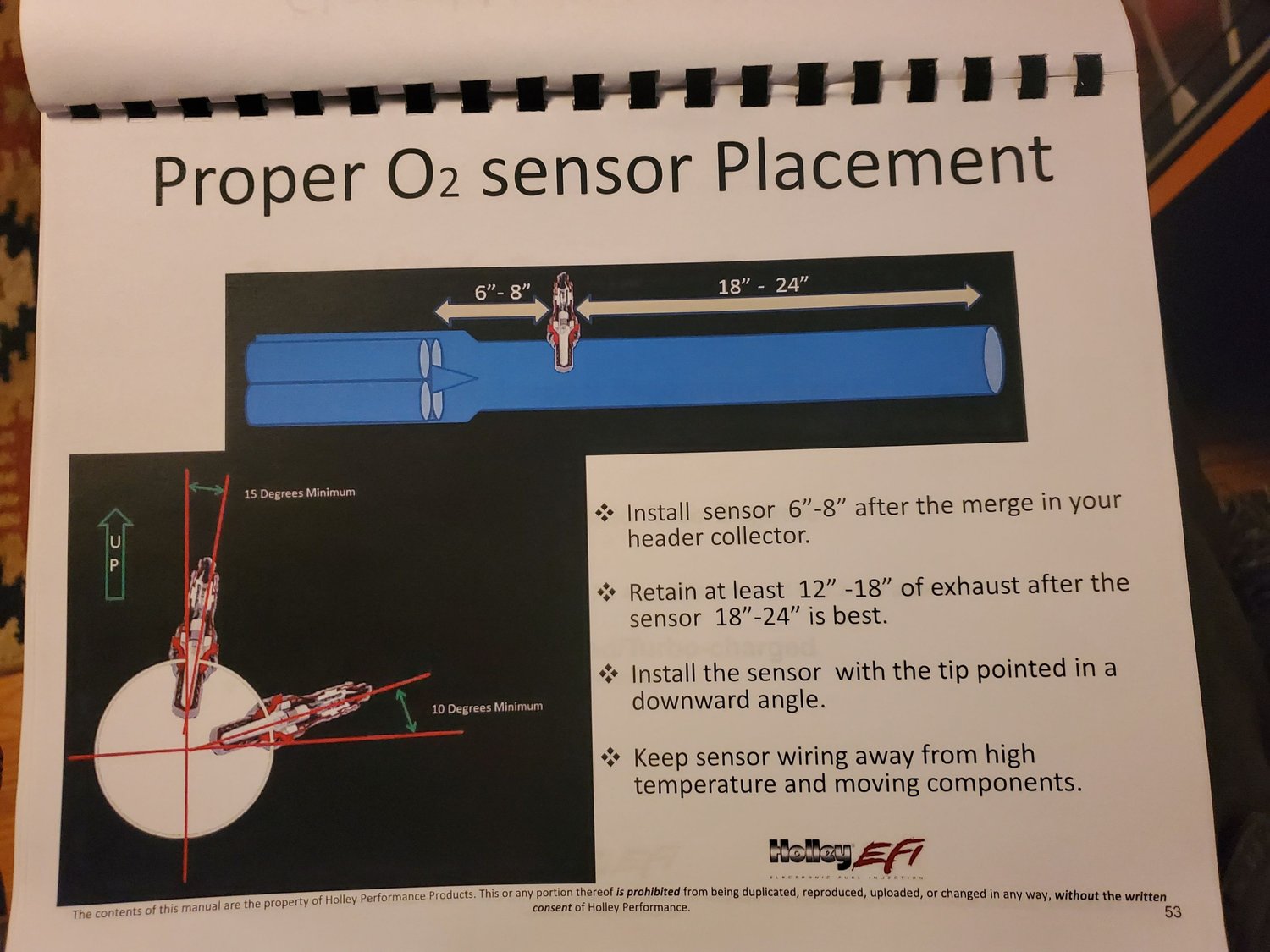

That seems really close to the tip, you check if theyre getting wet ?
I had some reversion at idle so I used to do the opposite, wait till I was on plane and running, making sure the 0`s were nice and dry and then turn them on.
Whats makes you think turning them on early and shutting them off late would help with lifespan? I wouldn`t run them at idle
2 things kill 02s , heat and water . You might also be reverting air since the tails are so short
