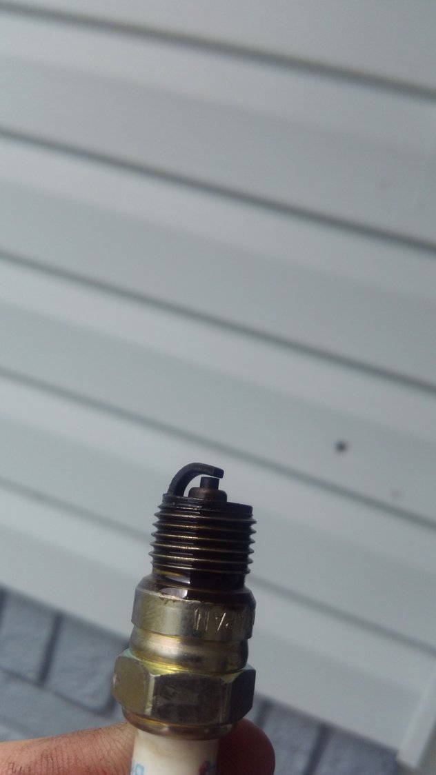

Pulled plugs. Cyl 5 appears to have its ground electrode pushed in towards the center electrode. All others appear normal albeit a bit rich.

Was 5 one that had high leakage?
Something dancing around in there.
Bore scope?
liberator221 is offline
